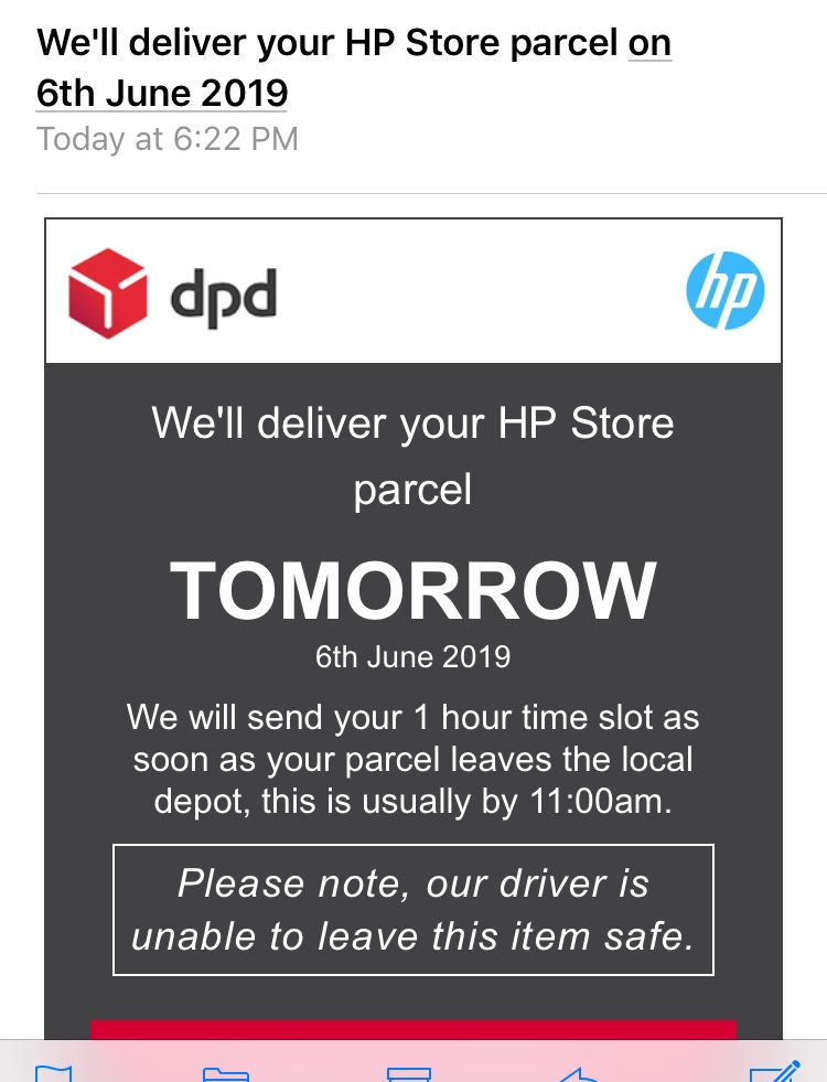

This is from the uk hp store if you’re wondering
