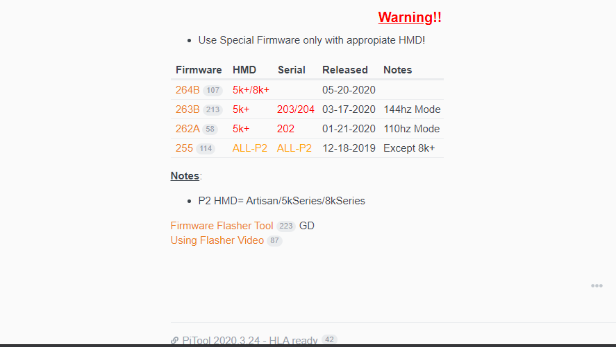

i didn´t extend my prescription about a year ago. nice to hear that it is no longer needed.
which update, i dont think it should be 262 as it states its only for 5k+ i have 8k+
maybe 264
