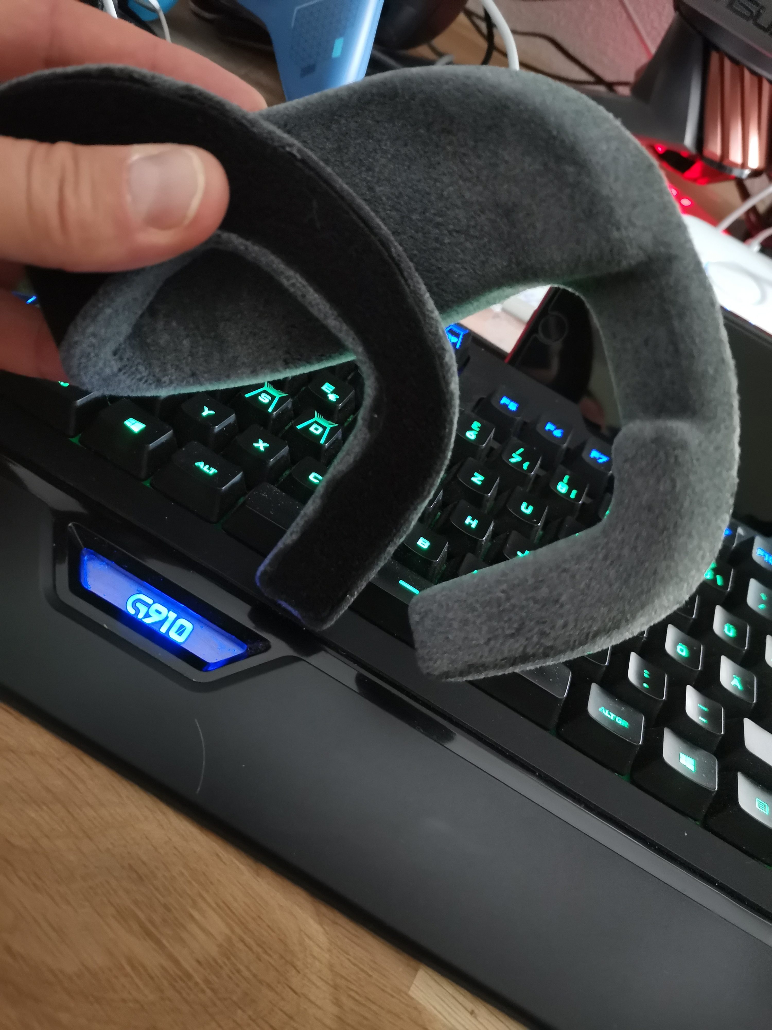

Yes, the cushion can be peeled of and swapped - no need to take off the plastic that is holding it (which is supposed to work also). I just did that to replace the original one (about 14mm) with a 6mm one, since I had trouble getting the sweet spot as sweet as on the 5k+. It worked in my case.
This is the cushion taken off:
Exactly, I can understand that depending on the use case the 5k+ is preferred, but at least the SDE and Immersion provision are better in my experience - worse only the slight softness of the image and maybe the latency in some cases (I did notice after the last update that I can see slight ghosting in special conditions - not sure if it is 260 doing it or I just never noticed it before).
We have the same keyboard!!
Enthusists Gear :stuck_out_tongue_winking_eye:. Else it most likely would be a razor :wink::grin:
