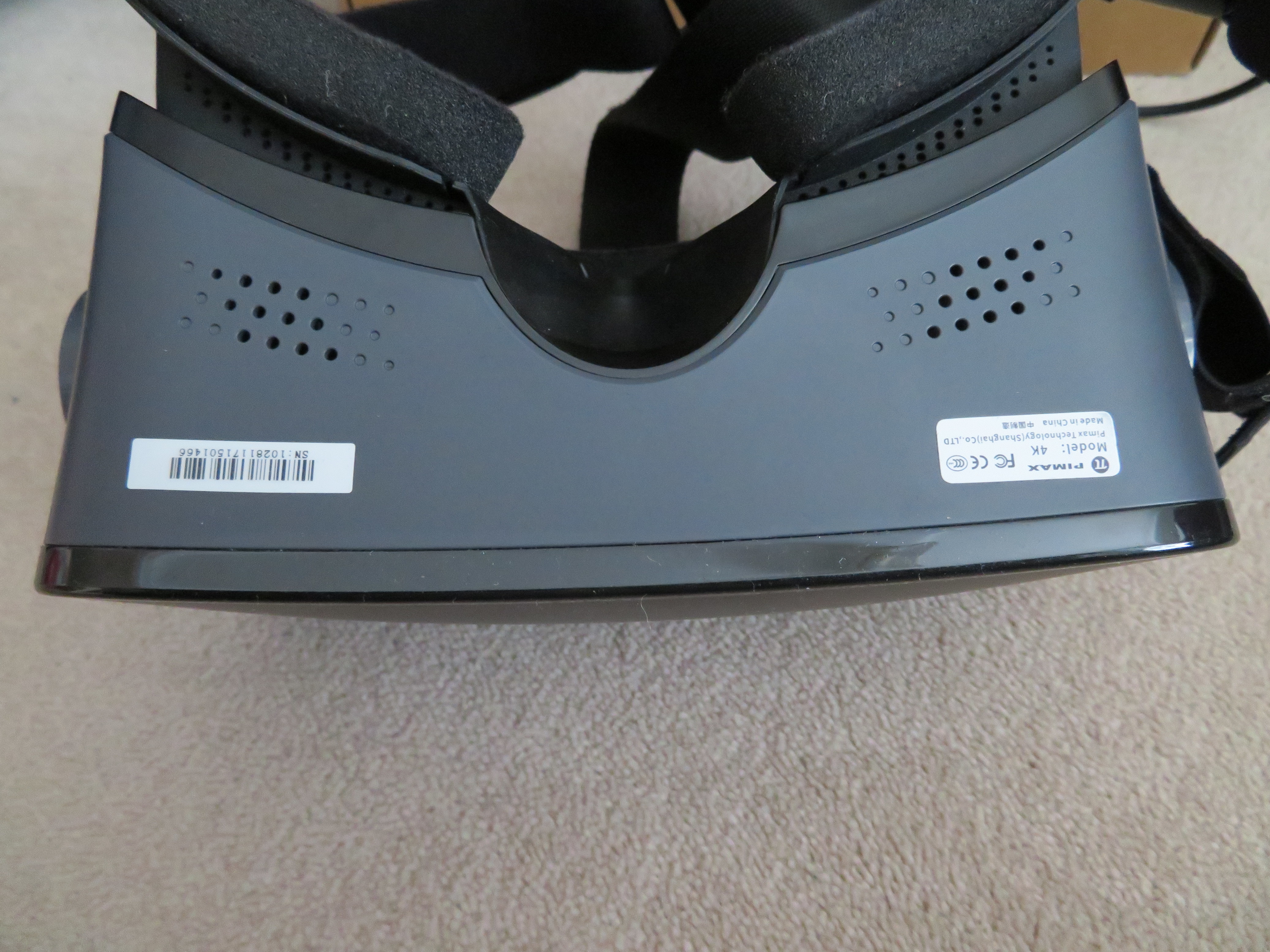

LukeB,
I have attached some hi-res photos of the 102 :slight_smile:
I hope they give you enough to go on
Well it looks the same as mine.
Are you sure there are no screws that keep the face rubber surround (pic 1) onto the body?
You have to force the rubber out of the way to see them.

LukeB,
Your video comes up as private and will not let me play it.
I explored further but my rubber face mask is Velcro’ed on to some very hard plastic hook material and with considerable force I was able to lift the hard plastic in one place in the area half way between both eye pieces but this revealed no screws. This model is really well built and has the appearance of being glued together.
There might be screws there but they are well hidden

Hey LukeB,
I found the screws ( I wish I hadn’t)
I tried and it died. I just converted a working display into a one eyed non working HMD.
I still have the blue light on top but only the right eye is showing any life. Unless the debug fixes such things (because I cannot read Chinese) the PiMax 4K has gone to the happy hunting ground.
