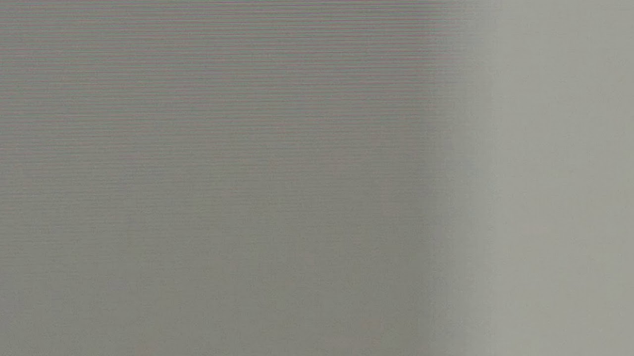

  2. Found flicking white pixel around the display, I see other people found same topic, will read later.
    https://community.openmr.ai/t/replied-flicking-white-dots-5k/12148

Sorry to hear that your replacement headset has problems . Do you still have your first headset ? If you do try changing the cable with your original one to see if that stops the flashing pixels.
Yes, may try again. The first headset, other backer are trying, I will get back soon.
Try unplugging and plugging back in the cable from the headset to get rid of the ‘snow’.

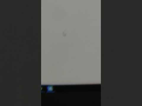

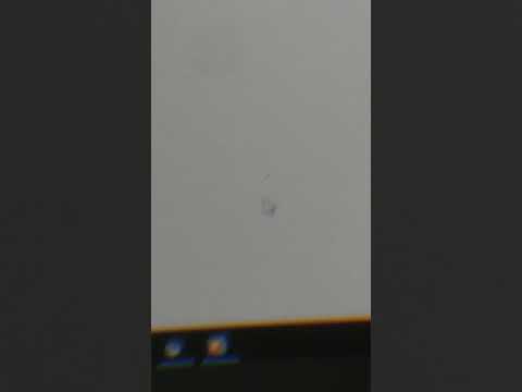

Right eye, big tear
Left eye, one dot. Just see another one (so has 2 dots).
I shoot 4k video.
Will open ticket tonight.

looks like dust not dead pixels
Yes, or some tear of film. Look so long.
New video here, look easier in 4k on pc.
