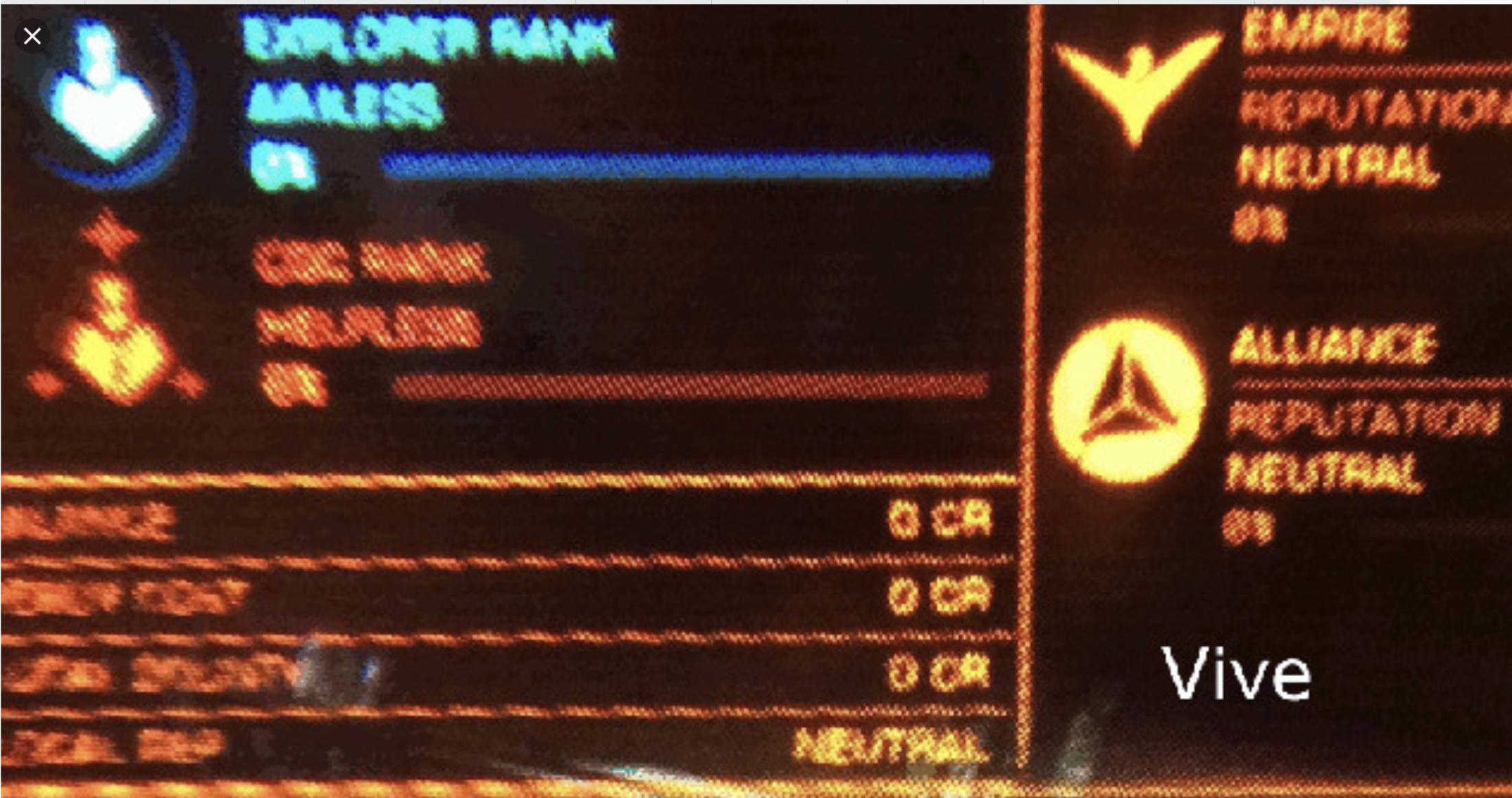

I am talking about this kind of shitty quality:
Got nothing to do with being short or far sighted, shitty is shitty.
Looks to me like Steam SS at lower than 30%, so the base resolution the game renders is too low.
Played yesterday subnautica on 20% Steam SS and realized immediately that something is wrong. Near Objects or near text was not really different, but details mid or far away looked jaggy. Performance was of cours much better :joy:
I found out that if you change Steam SS setting you have to restart steamVR to take effect…
Wow, you really need to do some thing with your setting, mine looks way way better than that.
It used to look like that when I first got elite :slight_smile:
It‘s a screenshot from the internet, but this is how it looked when I tried it with my Vive 1,5 years ago - same settings on the Rift looked clearer and I never went back because it has less SDE too. ED is of course knwon to look particularly poor on the Vive, but knowing that part of the problem is attributable to the game doesn‘t help much if it‘s exactly this game you wish to play…
With a 2080 you can of course go to SS settings which my 980Ti wouldn‘t have supported at the time.
