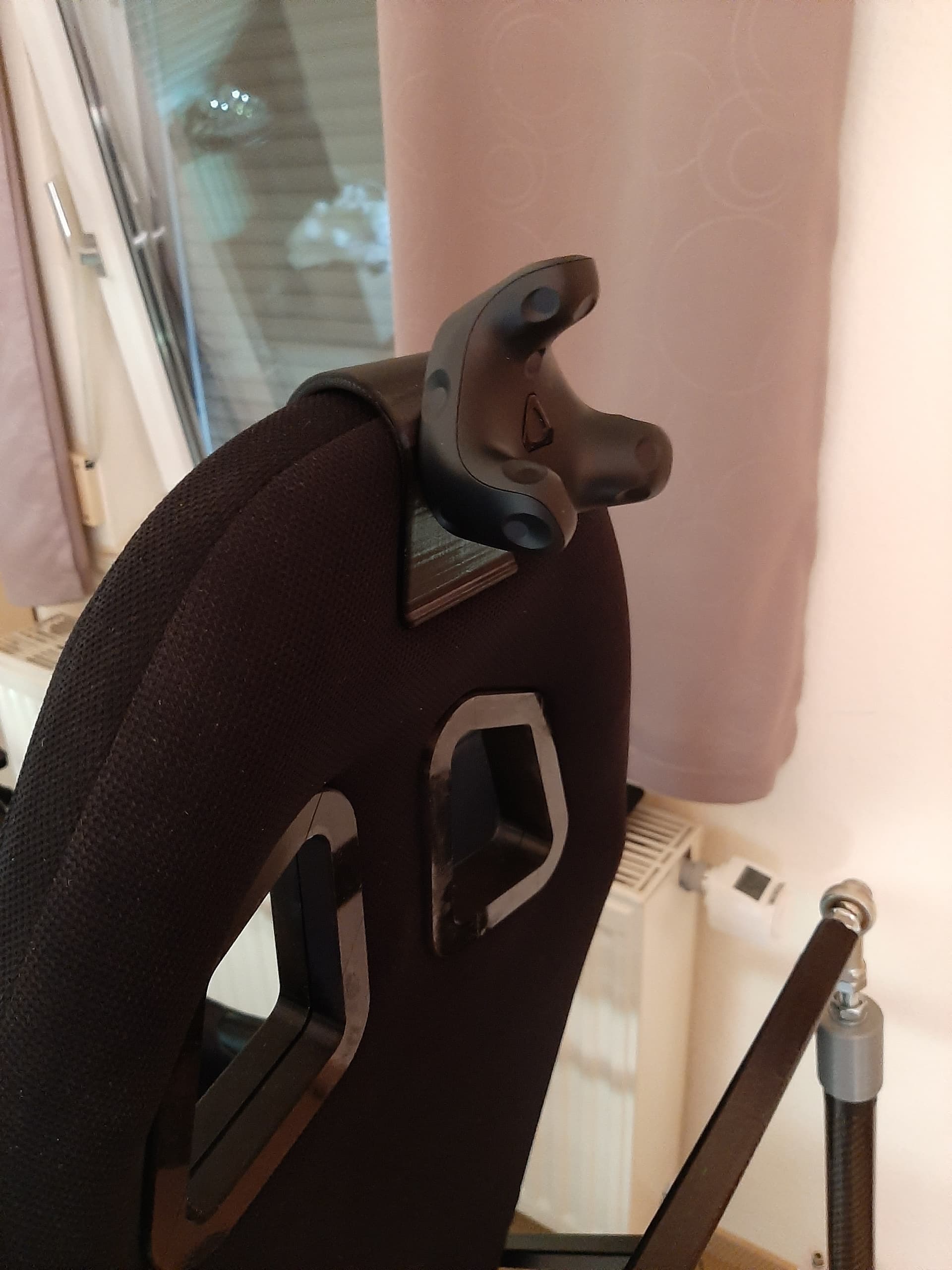

Hi,
I built a clamp to fix the tracker. This is the correct orientation for me.
 ![20220904_094635](https://community.openmr.ai/uploads/default/original/3X/c/0/c03fdebf9652f1b070cdae1cd4edb95f9dbe792b.jpeg)
 ![20220904_094647](https://community.openmr.ai/uploads/default/original/3X/0/c/0cfb39ff8c15cdf98090da6fe6efb9383b1ce6d2.jpeg)
A filter option in PiTool, to get rid of vibrations, would be very helpfull.
Thanks / Zennix
