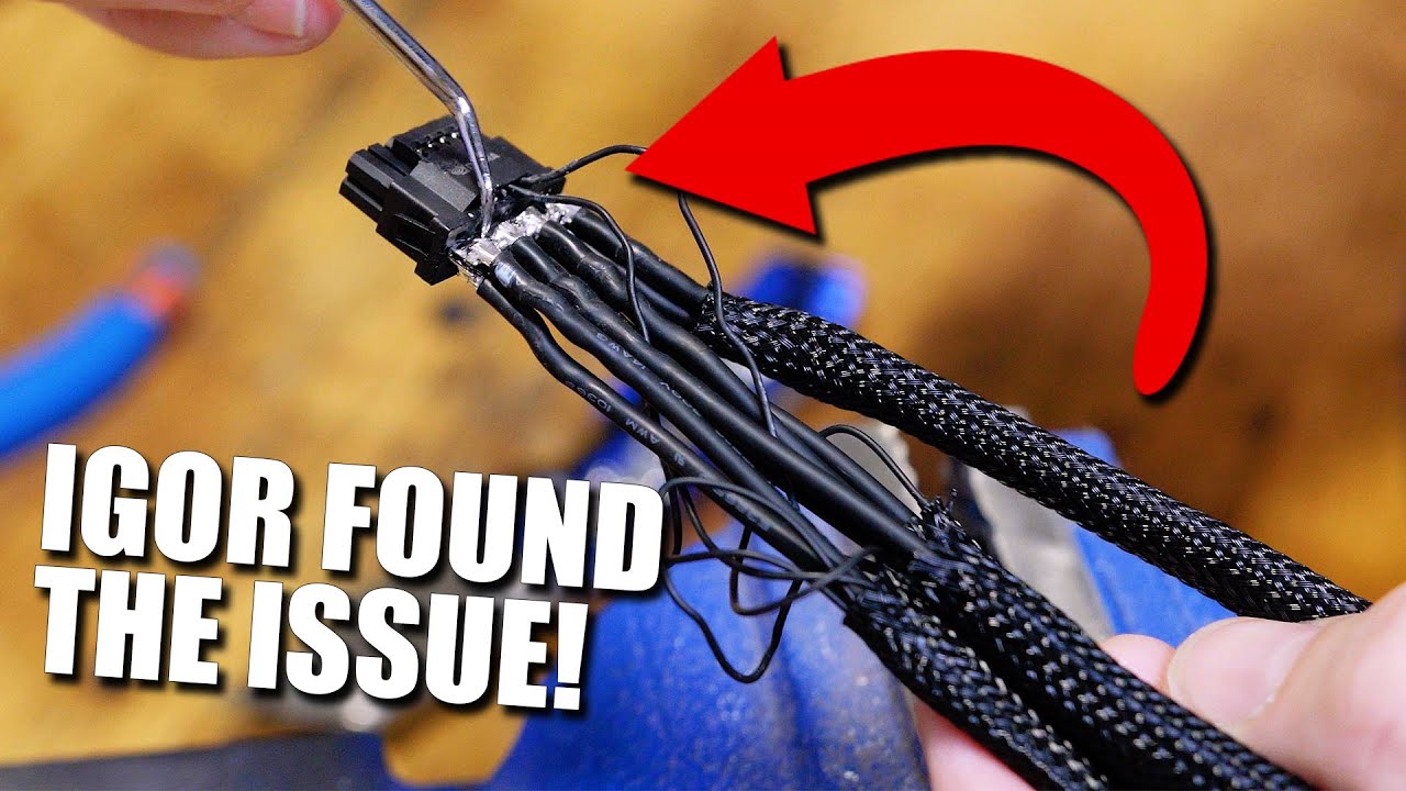

Igor didn’t really though. All he has is a theory. He did not actually test whether he could replicate the failure using that theory. And he also seems to have been dissecting what may have been a pre-release sample which is different and inferior to GN’s actual production samples.
Gamers Nexus did test Igor’s theory. In fact, they intentionally sabotaged their 12vhpwr adapters in various different ways and still could not get them to fail. That included even cutting half the wires and putting sharp bends on it.
I really appreciated GN’s video because it’s the only source of information I’ve seen on this issue with real credibility. They perform testing and a lot of it rather than speculating and making up or passing along rumors. And what I most appreciate about their coverage is that they refuse to draw any conclusions or accept anyone else’s conclusions which are not supported by data.
Even though that means their conclusion is inconclusive. They were not able to determine what caused this small number of adapters to melt yet.
However, what their testing (and all of the other actual testing I’ve seen) does show is that these small, fragile looking power connectors are actually tough little f*ckers. A lot of people speculated that they must barely be able to handle the 600W load they’re rated for, but actual testing to failure has them handling 1400W before failing… no wait. Actually, they did handle 1400W just fine. To get the connector to actually melt required 1400W AND intentionally having the connector partially seated. And that was finally enough to barely get it to start melting.
nVidia and Gamers Nexus have ongoing investigations into this issue. I’ve seen a lot of comments that it must be really bad if nVidia still hasn’t released any statement about it yet. But I’m pretty sure what nVidia is actually doing is performing engineering analysis on the problem rather than giving some jumping-the-gun PR answer. And real engineering takes time. This seems to be a difficult failure analysis because its apparently quite hard to get these adapters to melt without running them way over their ratings and/or intentionally sabotaging them.

Gamers Nexus also thoroughly debunks alot of the hyperbole in his video
Then if it is only a small number without becoming a trend. Cpuld simply mean a bad batch of adapters and/or bad connector on the gpus affected. Simply defects that were not discovered during the manufacturing process.
I think that is most likely the case, yes.
