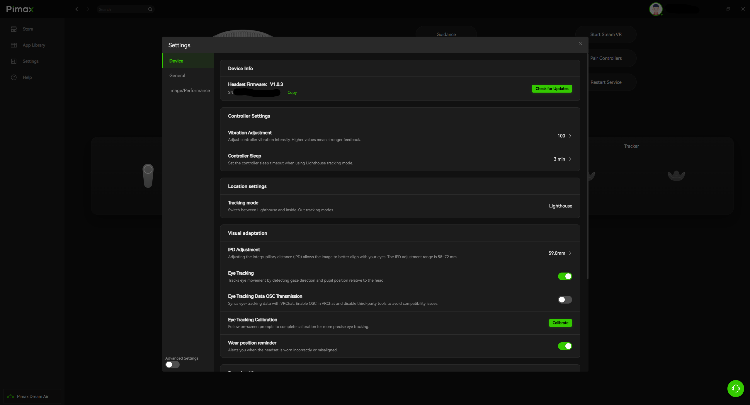

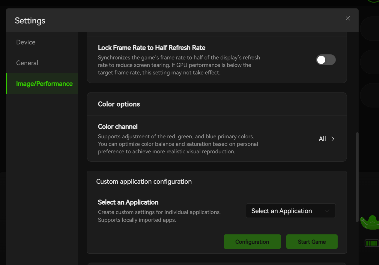

See below screenshot of where to find it now to customise per game. (this can also be done from the library now too.. Mostly..)
Also ensure you turn on “Advanced Settings” on the bottom left.. otherwise some crucial settings are hidden. some of which shouldnt be..
Ah thanks, but I don’t see Common Settings in the dropdown? I need Common Settings, adding SC as an app doesn’t work.
define “common settings”? what specifically are you looking for? as 2.0 everything has been moved around and renamed
Common Settings was the default application profile. This would apply to any application that didn’t have its own profile, and has been there for all PiPlay builds until 2.x. I would expect it to be an option from the profile dropdown. So even if you have never configured any application profiles before, that one should exist by default.
If it’s not available any more, I might have to revert and stick to 1.44, because that’s currently the one I need the most.
Ohhh.. that.. thats just Image/performance now.. whatever is set in there for graphics is what games will take by default if they..
A. Dont have their own dedicated profile.
B. werent launched using said profile.
Ah right, yes OK I see. That makes sense, thanks! :folded_hands:t4:
