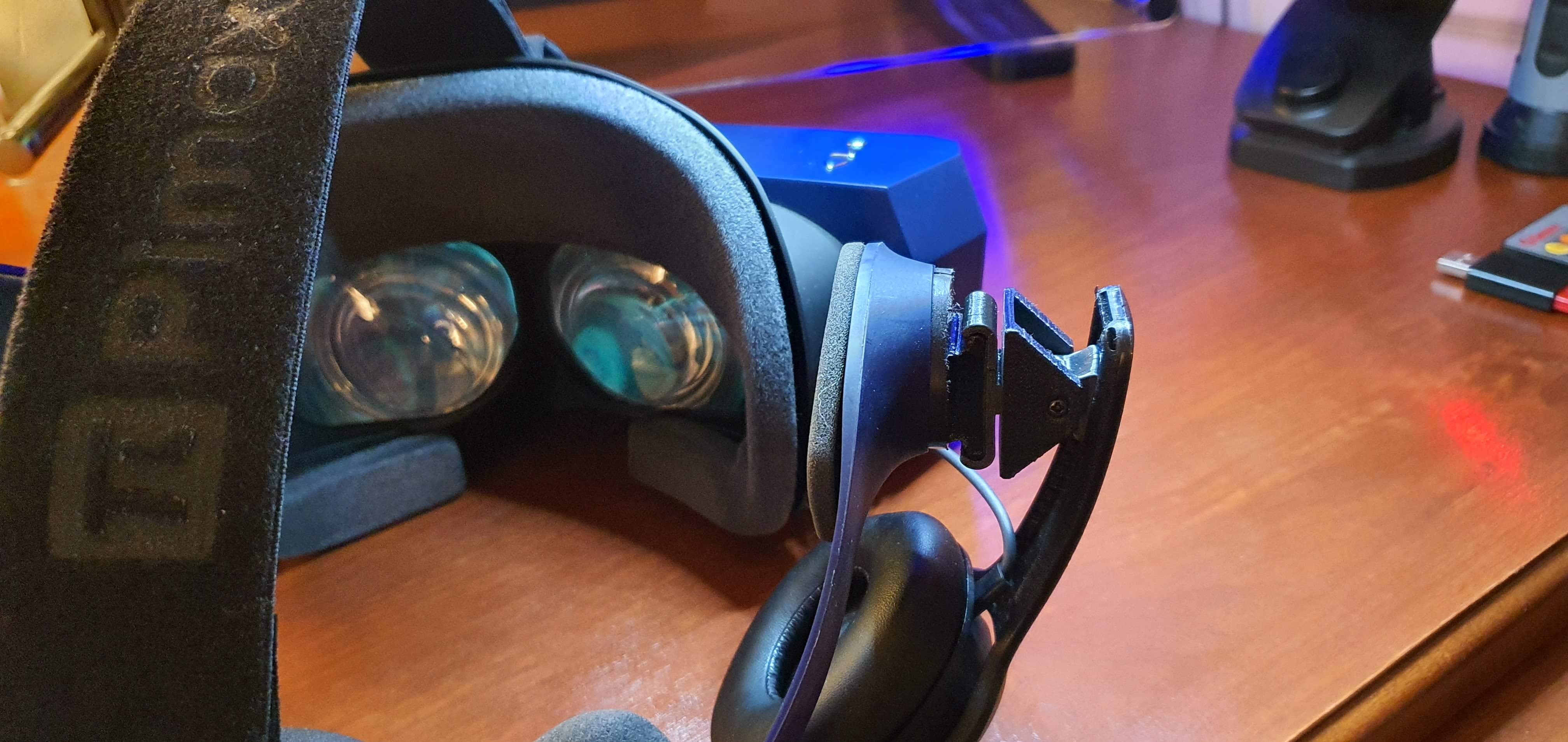

Great design overall although they are not “on ear” but rather “over ear” because of the thickness of the 3d print plug combined with the headphone adjustment piece so that the cans sit slightly angled to the ear rather than perpendicular. No complaints though other than some vigorous sanding to make things fit snug. Sound is very decent and a HUGE improvement over SMAS but not as much Bass as the Vive DAS, since they sit off-ear. I like them so much, for now, that I’m not even considering the DMAS or KDMAS. Awesome job and kudos to the designer.

So I was messing around and made the spacer a bit less protruding. I like it better as the speaker lays a bit flatter. Remember it is a tight fit and if you get any base layer expansion you may need light filing on the base edge or resize it a tiny bit in your slicer and use up to a 2mm screw to hold it in. Here is my remix;
perfect, thank you. Printing now

I printed 7 of the previous model to finally get to a fit that I felt was snug.
I’m happy when I set the width scale to
34.6mm fits nice and tight and is hard to pop out but can be done with your fingers.
the 34.7mm is very secure and requires i use clamp to pull out.
Both cause no damage to the MAS.

Ok so i printed the slim version and I think i will stick to the thicc one.
The slim one doesn’t seem to stay in as strongly. So unless i put a screw in i’m pretty sure the headphone would fall out.
