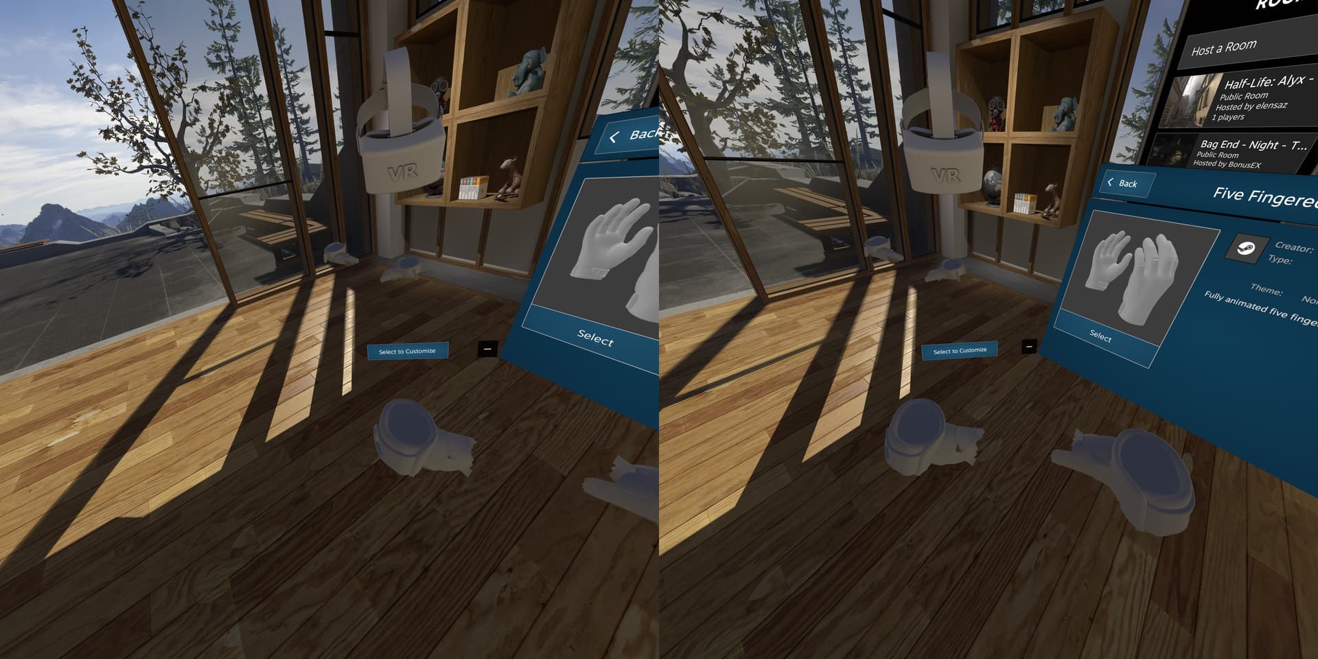

My index controllers have lost finger tracking. When testing with the steam vr software, everything seems ok, but in games that use finger trackiing, i.e Alyx, the animations are missing. Has anyone come across this problem and solved it? I’ve tried all the usual stuff, re-installed Steam vr, tried rolling back versions, re-pairing, hard reset etc. When setting the five finger animation in steam vr Home i’m just getting a broken wrist animation???

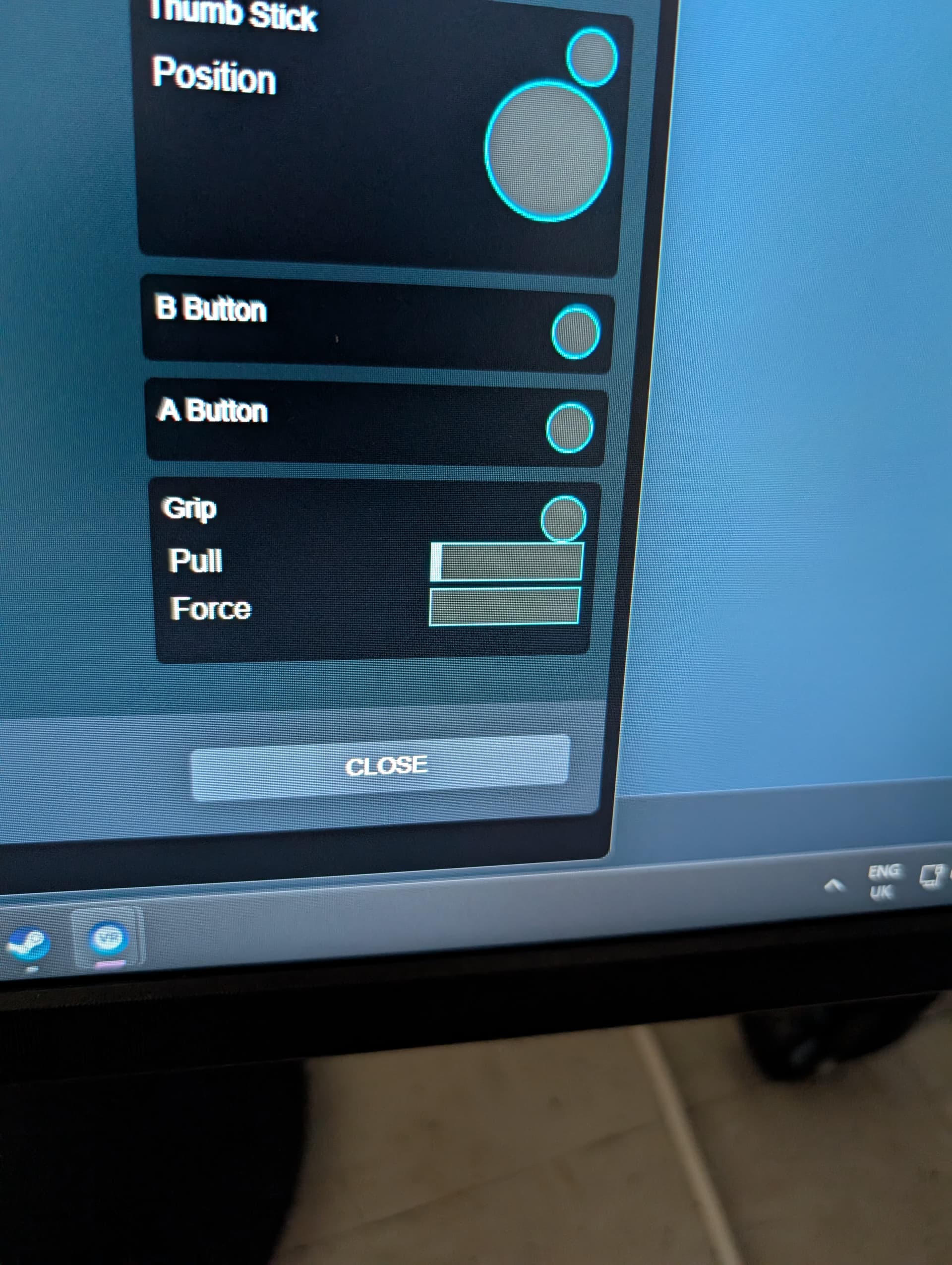

Have you tried using the steamVR controller diagnostic to see if any finger input is registered?
@BrziJoe …you genius. Just had to checkbox “gesture analog controller” and everything is back to normal. Not sure how it got changed as i leave all my settings alone. Many thanks, mate. You may have saved me days of troubleshooting
Thanks for the input @XRC . All sorted. I had tried the steamVR controller diagnostic tool and everything was working fine which was pointing me towards a Pimax Play problem. And it was.
