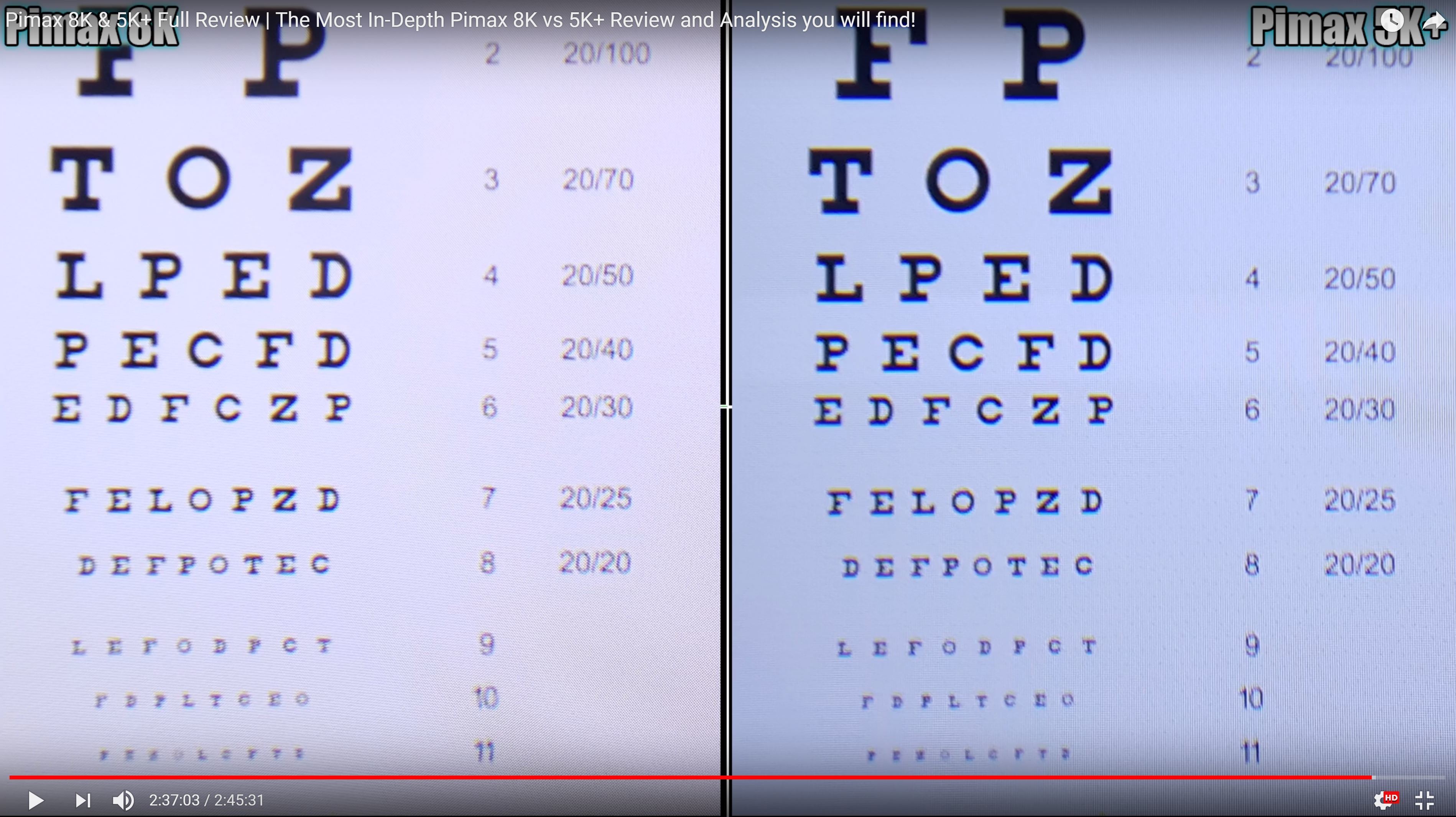

This photo is not accurate.
watch this moment: (2h:37m3s)
Yeah, I hear ya. It’s still a hard choice but it looks like the reduced SDE of the 8k may not be worth the extra pixels if the chip that scales the images will always be a hardware limitation. I think the SDE in both the 5k+ and the 8k will be so similarly small, that I’d really love to just try both - or buy both and use them for different things
Zoomed in photos are showing objects thay are close. You would need an unzoomed pic showing something off in the horizon so to speak.
Yeah ok, see that looks better.
Someone else review had a photo with a snip of part of a tree branch in the distance, the 5k+ was clear while the 8k was kind of brown smudges. That and the text is what got me leaning towards the 5k+, just because I imagined an enemy unit taking up that amount of pixel space on a screen and which would suit my sim games better. The reality is I don’t even know if I could see the difference while wearing either HMD
Indeed…
Also it seems as if the brightness of the 8K is much higher, not sure how much that could affect readability.
I deleted my first post, don’t want people to be mislead by that picture since it’s not accurate.
Yes the 5K+ looks to have a higher “blue” level.
and the 8K more like Apple’s “TrueTone”.

@sweviver’s video does mention the 8k has +4lux over the 5k+. Lots of info (still watching :laughing:)

The 5k+ and the 8K are so close that the through screen pics are of not much use. On some, the 8K looks better, on others the 5K takes it. I think that it’s just too difficult to get these comparison shots with the HMD’s being so similar.

2: In those video of SIM the reading of the cockpit instruments are munch more readable in the 5K+ just take a second look.
The 8K zoomed images are showing a strange dithering pattern that don’t like but in some case this dithering helps our brain to forget the pixel patterns because it’s blurring the image
Watch all of Sweviver’s review. Keep in mind with zooming the image you will notice fine differences. Just like you will with a High quality laser like injet vs an actual laser printer’s print.
