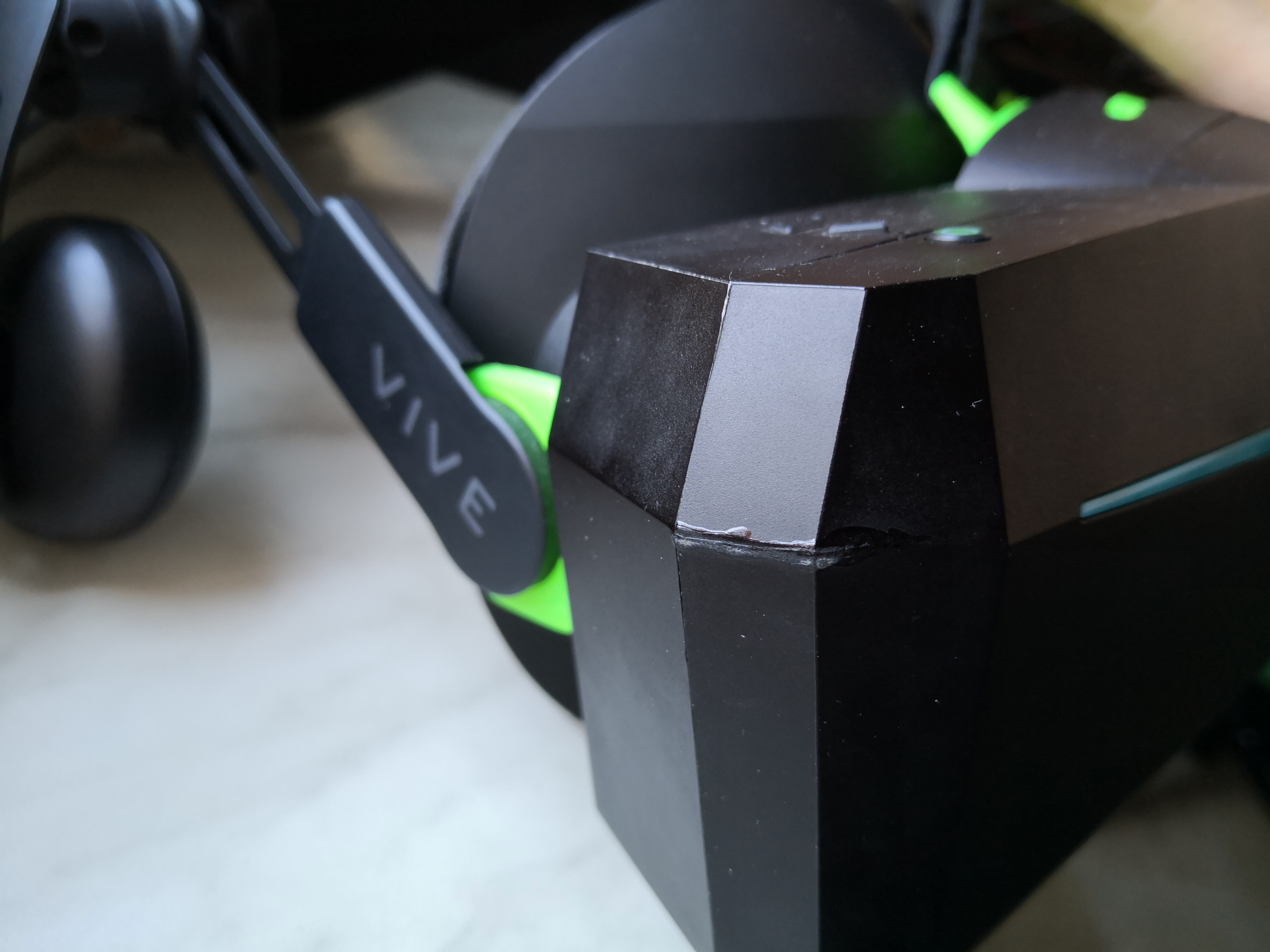

It’s not pretty but it does the job for me :grin: checked again for cracks and discovered a new one (last pic) so here we go again :joy:
I used a little toothpick. Took a bit of superglue on the tip and carefully applied it on the crack again and again with drying in between. I worked vertically, so no droplet can potentially damage parts inside.

is the glue black or clear?

I used standard clear superglue (ethyl-2-cyanoacrylate) :wink: i guess a black one should make no difference, i checked the locations of the sensors anyways (e.g. from the silicon protective sleeve pictures)
It definitely attacks the plastic a bit. As i said - its not nice, but works for me :smile:
FYI - Pimax specifically said not to use super-glue. I’m thinking quick-setting epoxy might be a good choice.
