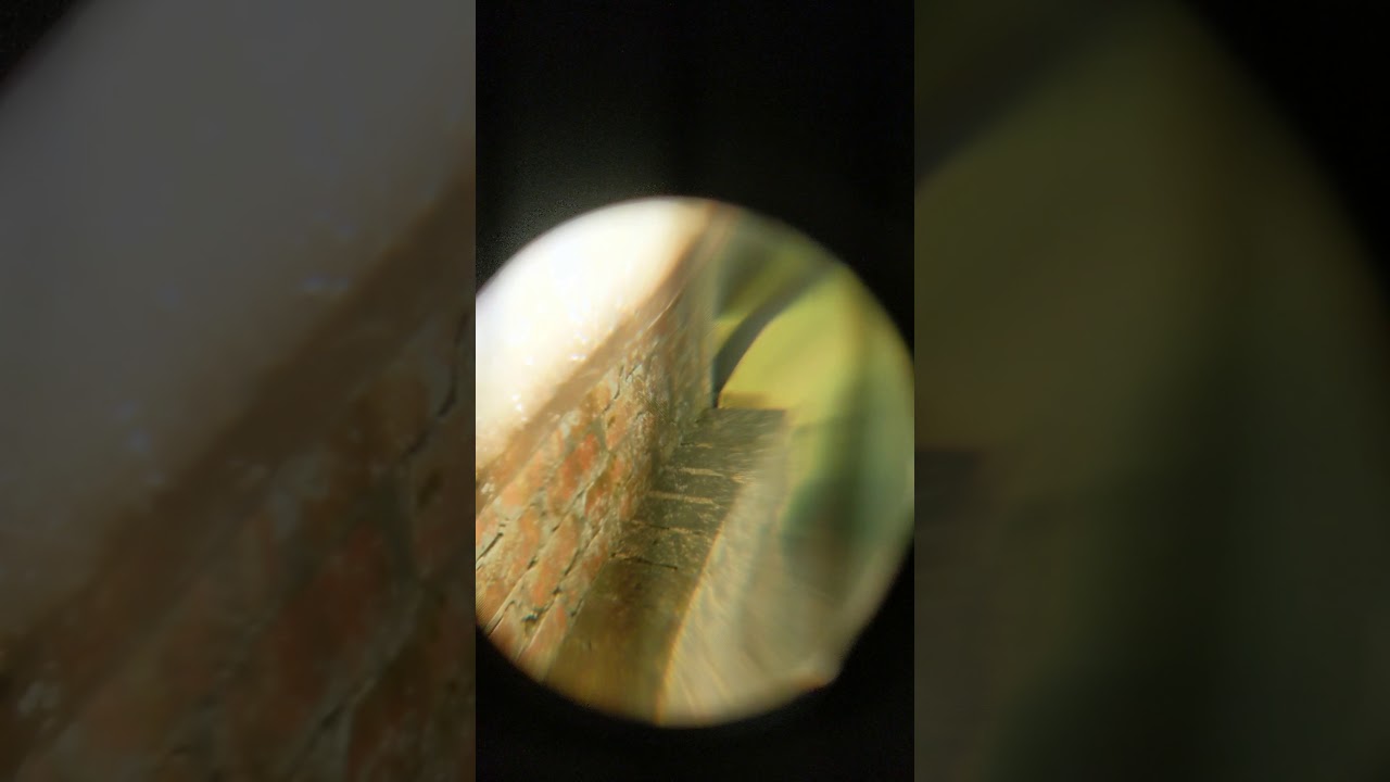

This person rates a modded Vive pro over his Index!!

A typical example of one not necessarily comparing what one believe one is comparing,
Don’t get me wrong; I am a great proponent of smooth lenses and OLED displays, and both these can not but give the guy considerably better contrast, etc in the Vive.
…but…
In that video he is running Alyx at 144Hz on the Index, and 90Hz on the Vive Pro (100% render size on both), believing that this way he is giving the Index all possible advantages, but not realising that the difference in frame rate will be directly reflected in reduced actual render resolution for the Index, due to Alyx’s adaptive quality kicking it down, in order to be able to maintain that higher frame rate.
…so everything he says about being able to see details (except that which concerns e.g, being able to resolve things in the dark), has to be taken with a generous pinch of salt.
