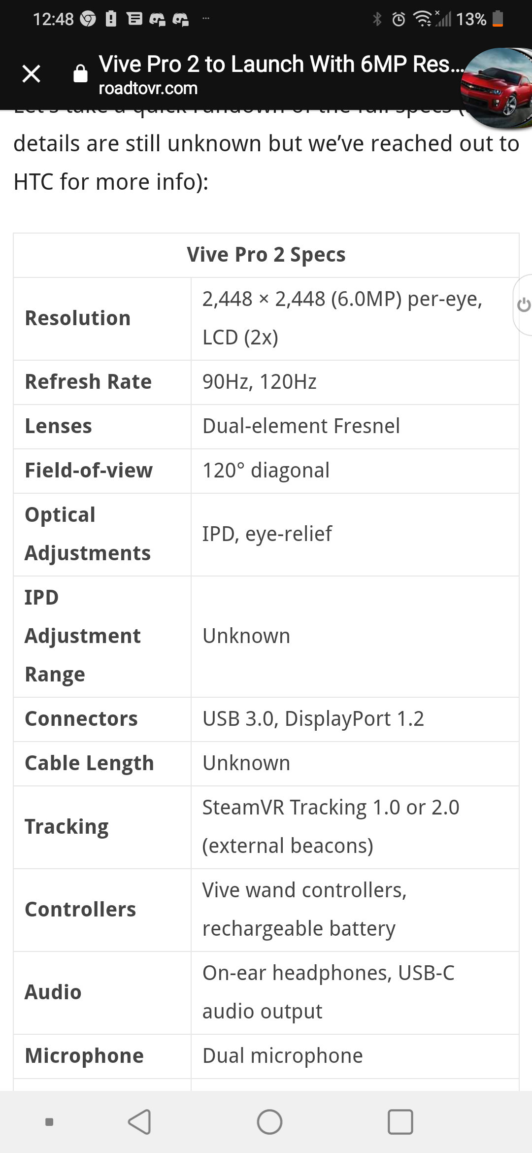

Why are you assuming it’s 120 degrees diagonal? MRTV said the HTC Vive President told him it is 120 degrees horizontal. However Sebastian seems skeptical of that claim, and because HTC doesn’t specify whether it’s horizontal on their website, leads me to believe they are covering up for an unremarkable 120 diagonal. It would just be weird they’d market that as “Wide FOV”

Read The Article @Djonko posted(RoadToVR). It specifies Diagonal. Which seems more likely than wide as it like g2 is using square 1:1 panels and we know that the G2 is limited by FoV because of this. I suspect like the Index people are presuming the FoV is 120 wide as many folks presumed the index was 130 wide due to up to 20° more FoV.
So the question is. Is RoadToVR given posted the proper specs vs MRTV? Math wise it seems like 120 diagonal is legit.
Nowhere in the HTC advertisement vid clip does it say 120° horizontal.(in article)
It does say “Full 120° FoV” then next line mentions Horizon. So likely people mistook Horizon with Horizontal.
It’s possible roadtovr has it wrong because “diagonal” is never specified on HTC’s official website specs.

  • I looked at the lenses on the Vive Pro 2 showcased on their website and they look pretty big. The vertical FOV looks similar to a Pimax headset. So since resolution is a perfect square 2448x2448, it could be 120 degrees horizontal AND vertical. But they advertise horizontal because thats the number most people care about.
