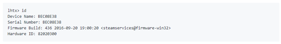

btw. what i see from LighthouseRedox/Base Station Shell.md at master · nairol/LighthouseRedox · GitHub is that the Device Name == S/N of the Basestation.
AdditionalQuote:
The Base stations can be put to sleep and woken up via a Bluetooth LE GATT characteristic. Also they can receive radio firmware updates. The “Name” and “Alias” characteristics contain a string “HTC BS xyABCD” where xy is the last byte of the Bluetooth address [which we have] and ABCD is half of the base station unique identifier [which is half of the name].
For the basestations’ S/N have a look into $(root)\Steam\config\lighthouse\lighthousedb.json or into $(root)\Steam\config\steamvr.vrsettings.
Thanks, yeah, the serial number is printed on the back of each base station and it’s available via soldering a serial cable to the PCB, but I’m looking for a way to automagically setup the base stations (without user input).
