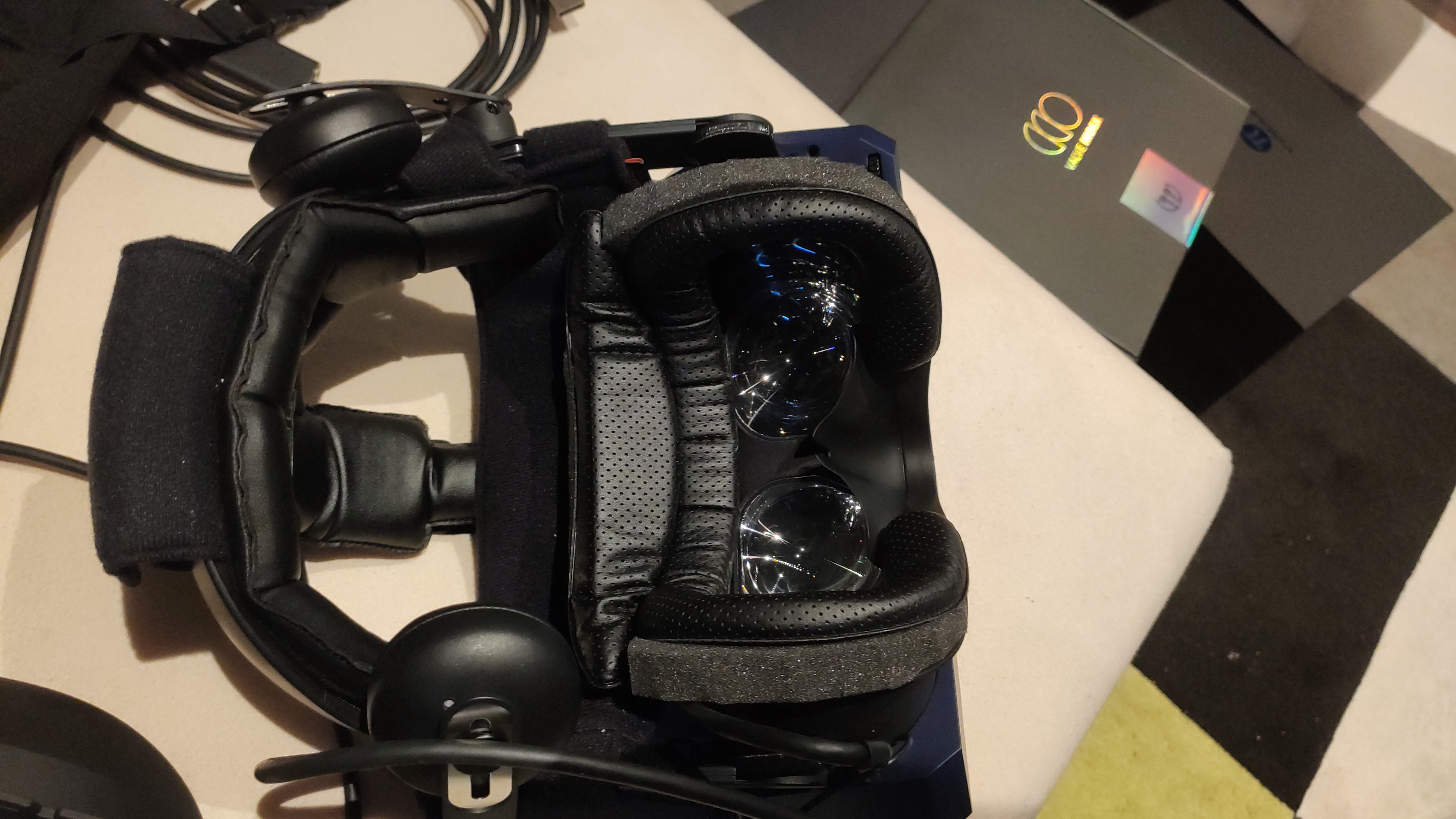

your hypothesis. the right place to confirm this is the forum. i belong to the group with lower ipd. I have a relatively narrow face. I cut foam and put it under the cover. it helps. I don’t have to do that with the 5k +. in the picture the foam is still very big. Work gradually until the sharpness and comfort is right. it also helps a lot in putting that weight on the side of the face. and the hmd can no longer slip sideways. very comfortable to wear. you should try to find the right settings for you using a test image. everyone has a different face.

I’m close to the limit, but still solvable and usable. I pull out the foam wedges until it fits. that may look a lot in the picture. but it is not. my ipd is 63-64. what bothers is my big nose. the hmd is poorly constructed in terms of space.
