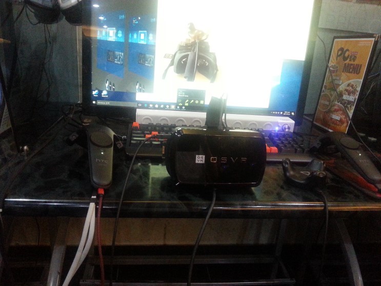

Yes. I am using Vive’s Lighthouse in OSVR.
The following picture is taken after successful test with OSVR HDK1.4.

I flashed two Steam controller dongles and paired them to my Vive wands. So far so good. when I go into steam environment the controllers are present but across the room and turned toward me. Me is the headset. the controllers are oriented so they are pointing opposite what they should be. They do function correctly. I tried running room setup. Do you have any suggestion about how I can correct the placement of the controllers? thanks.
It is possible to operate the pimax 4k through OSVR. But I think the best way is for the pimax engineer to make this workable via piplay.
