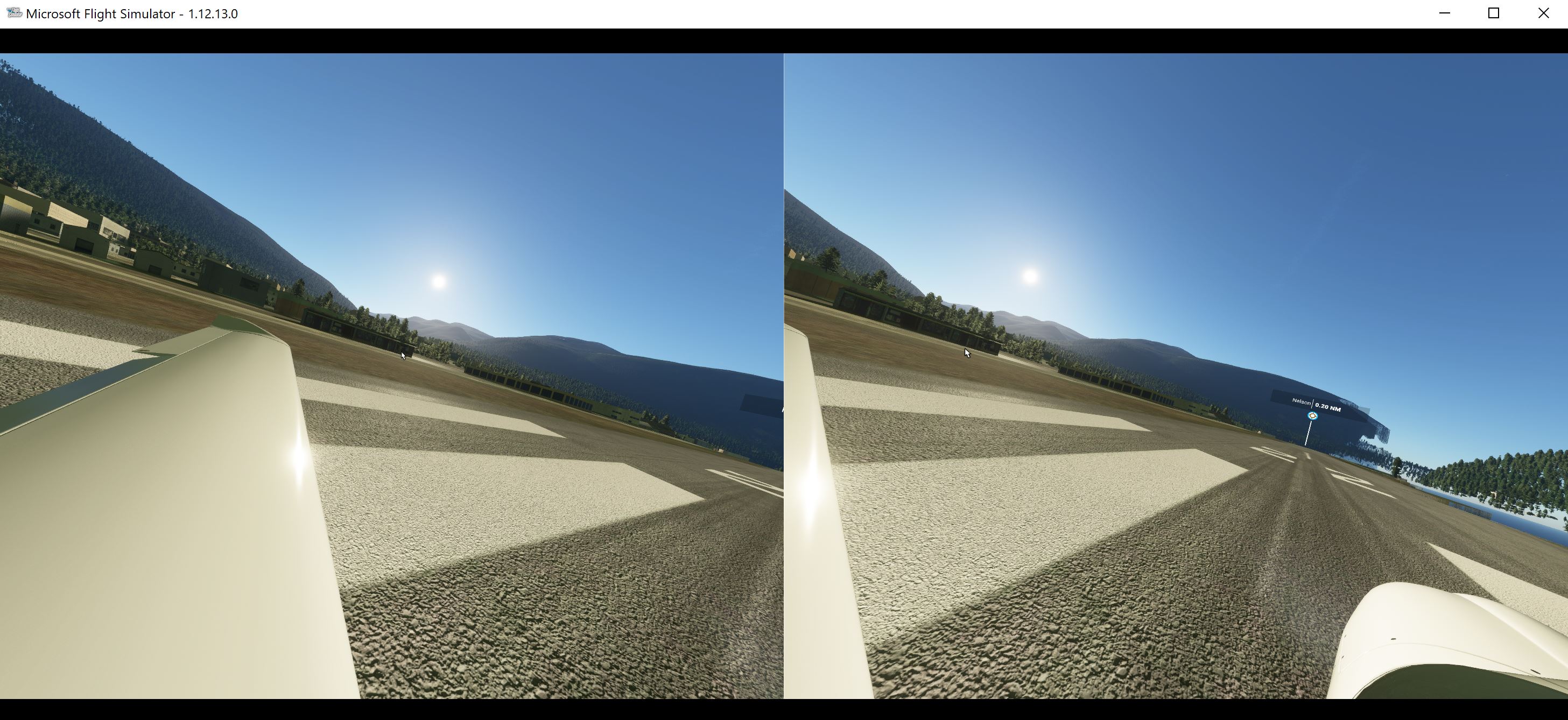

@SweViver I noticed your desktop view looks different than mine. I wonder if this has anything to do with the culling.
For me I literally did nothing but start the game up like normal from its desktop icon and press ctrl-tab. I already had PiTool running (and technically I didn’t have SteamVR running, that ran itself). And like I said, for Settings in PiTool I had nothing turned on except FFR was on balanced, no other options were checked.

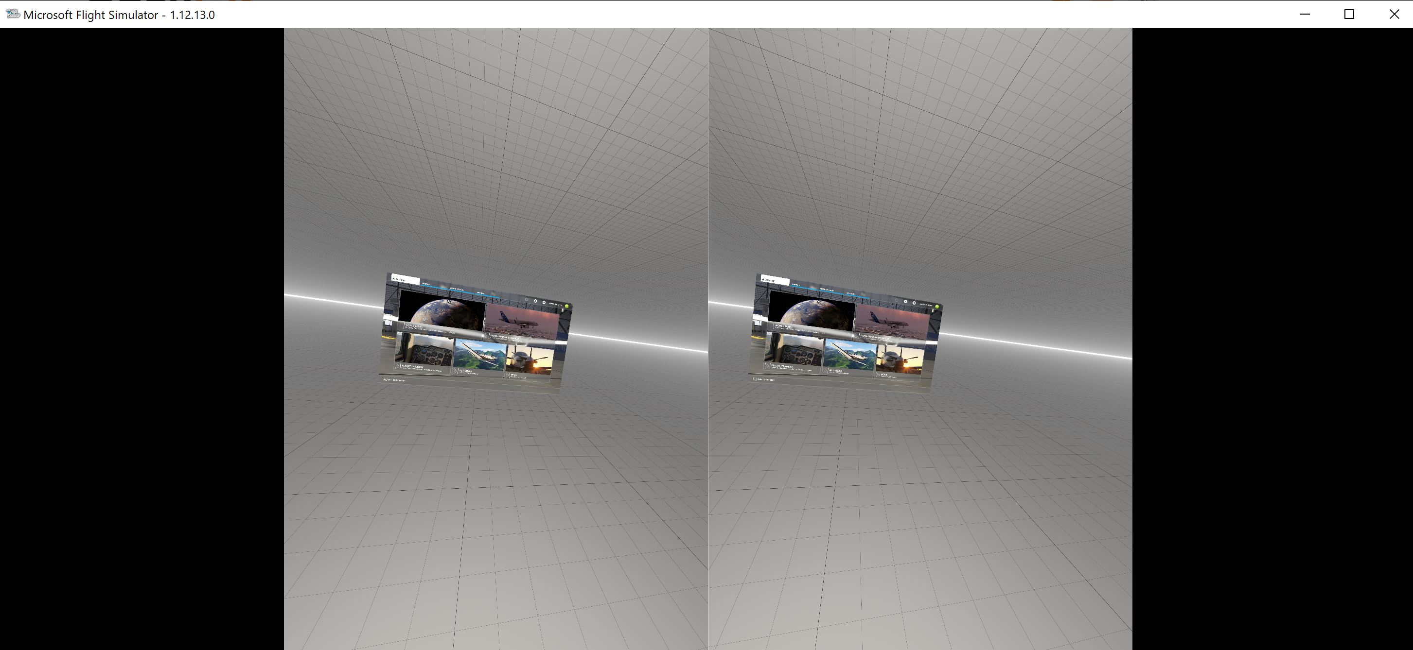

Oh, that reminds me, maybe that’s what fixed the canted display issue - one of the things I tried while having that was to press the Home button to see if I could recenter the view in the SteamVR menu. Maybe that somehow fixed something…dunno, I was trying lots of things.
Nope, it looks the same in the main menu on my side (square edges).
But once you start a flight, it changes to the “rounded” image (basically the image that is sent to the panels)

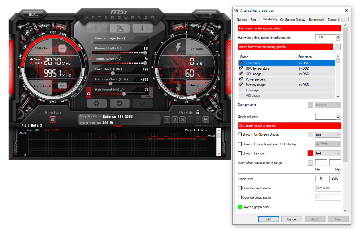

What are you using for that CPU/GPU usage? That looks a lot less intrusive than the Flight Sim developer FPS meter I normally use.
Its just the good old MSI Afterburner (OSD). Only visible on monitor of course and not in VR view, and you can change the monitor position, add/remove values etc.

Here’s my in flight image. Squares instead of cropped edges. I wonder if this is something…
I deleted my steamvr.vrsettings file but no change.

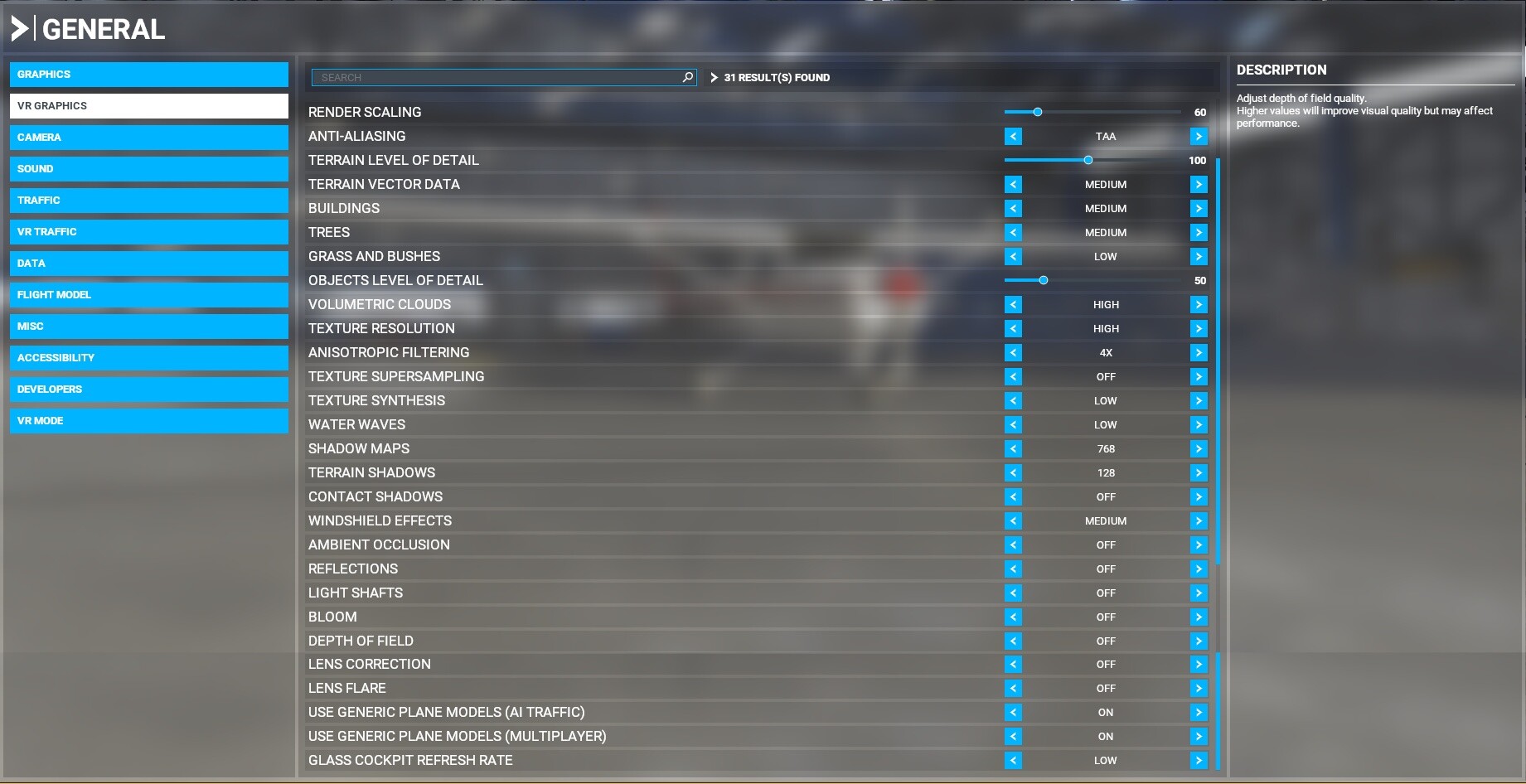

Here are my setting after 150hrs of using VR beta, mainly in C152, hope it helps someone with performance tuning:
Ryzen 5 1600x
RTX 3080
16GB Ram
Refresh rate 64Hz, motion smoothing on.
Pitool 1.0
SteamVR resolution shows around 2600p vertical.
FOV Normal with PP off (don’t mind culling, prefer it over small FOV with PP on, similar performance).
For the most part i can keep sim smooth, above 32 FPS for motion smoothing to work, except for large photogrammetry cities and some large airports.
A320 and aircraft with glass instruments create stutter on my machine on lower but are generally OK at higher altitudes.
Can recommend installing prop mod to reduce motion smoothing artifacts.
