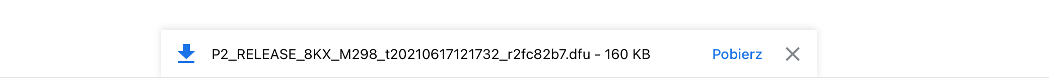

As You can read in this topic, it works for me using a firmware which was provided by support.
You can either wait for it’s release or ask @PimaxUSA if You can test the firmware (*r2fc82b7.dfu) too.

do you have this one ? :
