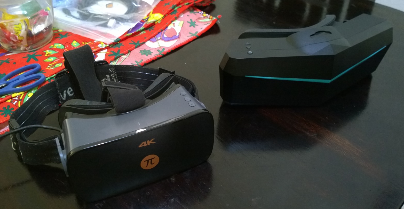

Some Pics…
Father and Son.
The new Family member … Welcome Home.
