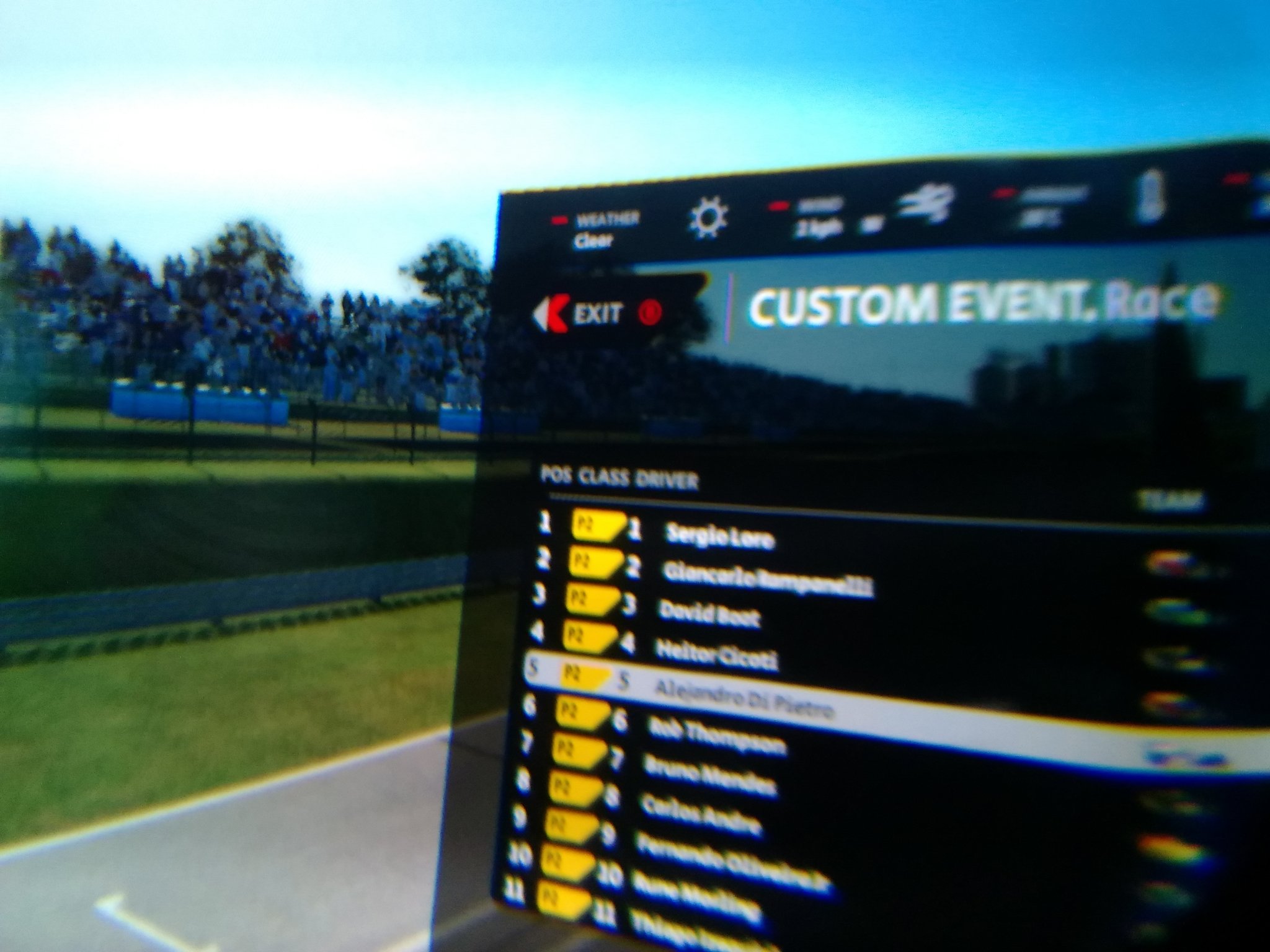

Taking a picture of a VR display is very difficult.
I tried it.
Notice the edges of the transparent black menu background.
The top of the rim is yellow and the sides are bit blue.
Visible to my naked eyes, but my eyes are tired?

@coverman Ok, I see the chromatic distortion in those images. Please inform, do you see similar chromatic aberration at the edges of text, or just the edges of the big panels?
My sense of scale might be wrong, but that looks much more severe than I would expect for an 8kX (or any modern Pimax), unless that is somehow a SteamVR overlay (which the chromatic aberation correction software cannot address).

Are those photos made with render quality at 0.75 ?
This phenomenon needs to be confirmed in multiple game titles.
I think it only appears in the Automobilista2 in-game menu screen.
The same was true for render quarity 0.75 and 1.0.
It is the same even when the post effect is turned off.
But it may be a unique drawing representation.
I need time to test. And today is still the first day.
I played it yesternight… I did not see those distortions in real in the 8k+, but clearly in your image. I will check tonight with less sleepy eyes I hope.
Chromatic aberration should not be happening within a single VR app, only between VR overlays like OVRDrop and underlying VR Apps. Unless maybe you are using Oculus API (no SteamVR running).
