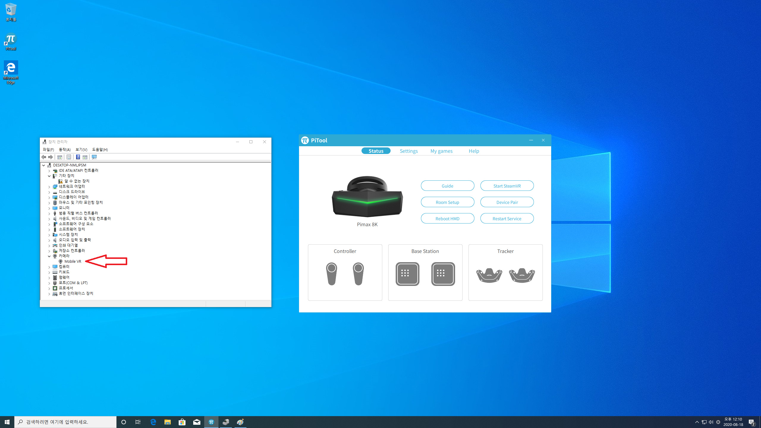

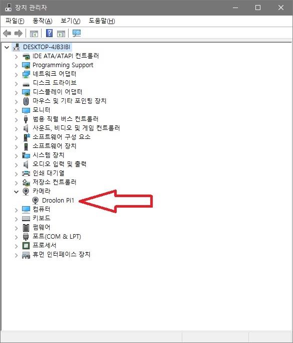

I reinstalled Windows 10, but it doesn’t work.
There is no more workaround. Ha ha ha
This may be a problem with the product or Windows 10 build 2004…
Damn, to bad man :confused:
Guess it is time for a support ticket then?
It also doesn’t work on Windows 10 build 1909.
I tried connecting it directly to the computer with a USB cable, but it is the same.
Now it’s time to get tickets? T_T
I also tested it on a laptop.
It is the same again. “Mobile VR”…
I opened a ticket.
We have received a response that our eye tracking service has received a request for assistance and will contact you as soon as possible.
I will report every time as it progresses.
Solved!!
I opened a ticket and received the eye tracker firmware by email.
It solves at once~~

Thanks, I raised a ticket now for myself, also got the Mobile VR in the Device Manager, looks like maybe these are from the very early badges which were not branded by Pimax. Glad this is now working for you with the 8K as well !
It is expected that many people have received products with the wrong firmware stored. ha ha
