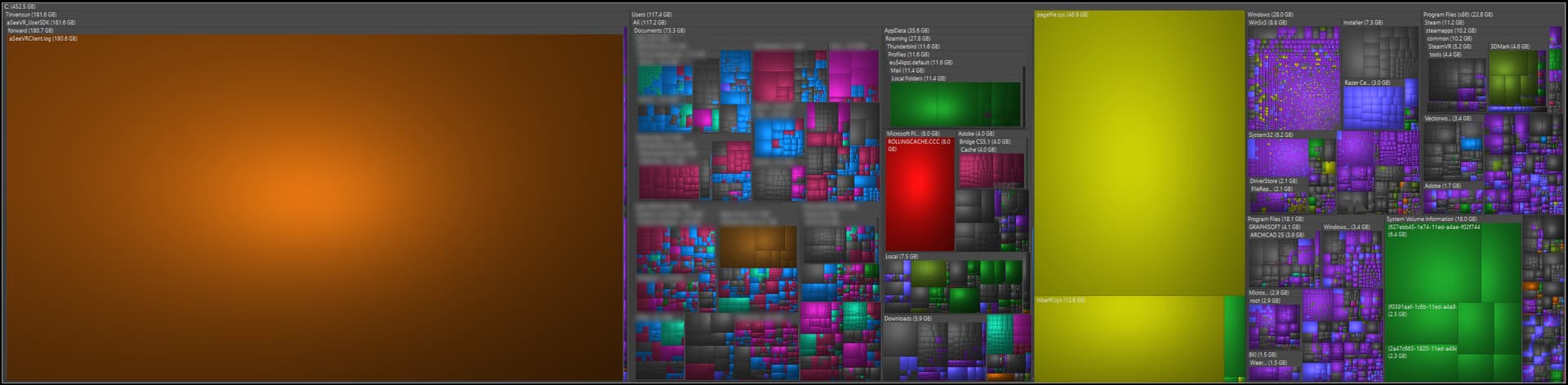

Here’s something weird I’ve discovered. I had some issues with my system crashing to desktop from various VR games after a couple of minutes (MSFS 2020, War Thunder, Star Wars Squadrons) in the past few weeks. Today when I wanted to know why my drive was nearly full, I saw that 40 % was taken up by a file named aSeeVRClient.log. I will try to find out whether this issue caused the crashes or vice versa. (Sorry I can’t keep this file for troubleshooting purposes, need my drive for work!) See WizTree image of my drive attached below: The big orange space is the .log file, 180 GB. When I deleted it, I had to close forward.exe, which apparently I hadn’t done after the latest MSFS CTD.
I’m gonna assume all of the purple squares are …ahem…nature videos and tax forms
Hello Arend!
so the aSeeVRClient.log is a bug that happens where every error it logs it on a file. but it tends to be the same error with a different timestamp on loop for eternity. Currently working on fixing that. But it is quite time consuming on updating this especially because I have to decompile and recompile everything.
just as that bug happens, delete it until I can get that fixed lol
