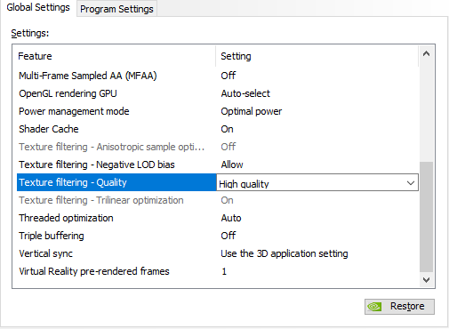

What was your nvidia control panel set to …?
1… ā€œLet the 3D application decideā€
2… ā€œUse the advanced 3D image settingsā€
3… ā€œUse my preferences emphasizingā€

ā€œUse the advanced 3D image settingsā€, but the only thing I changed from the default settings was ā€œTexture filtering - Qualityā€ to ā€œHigh qualityā€.
nvidia_settings
