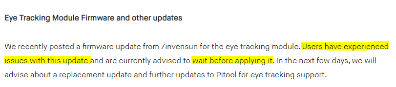

Apparently Pimax is advising that users stay away from updating the firmware
