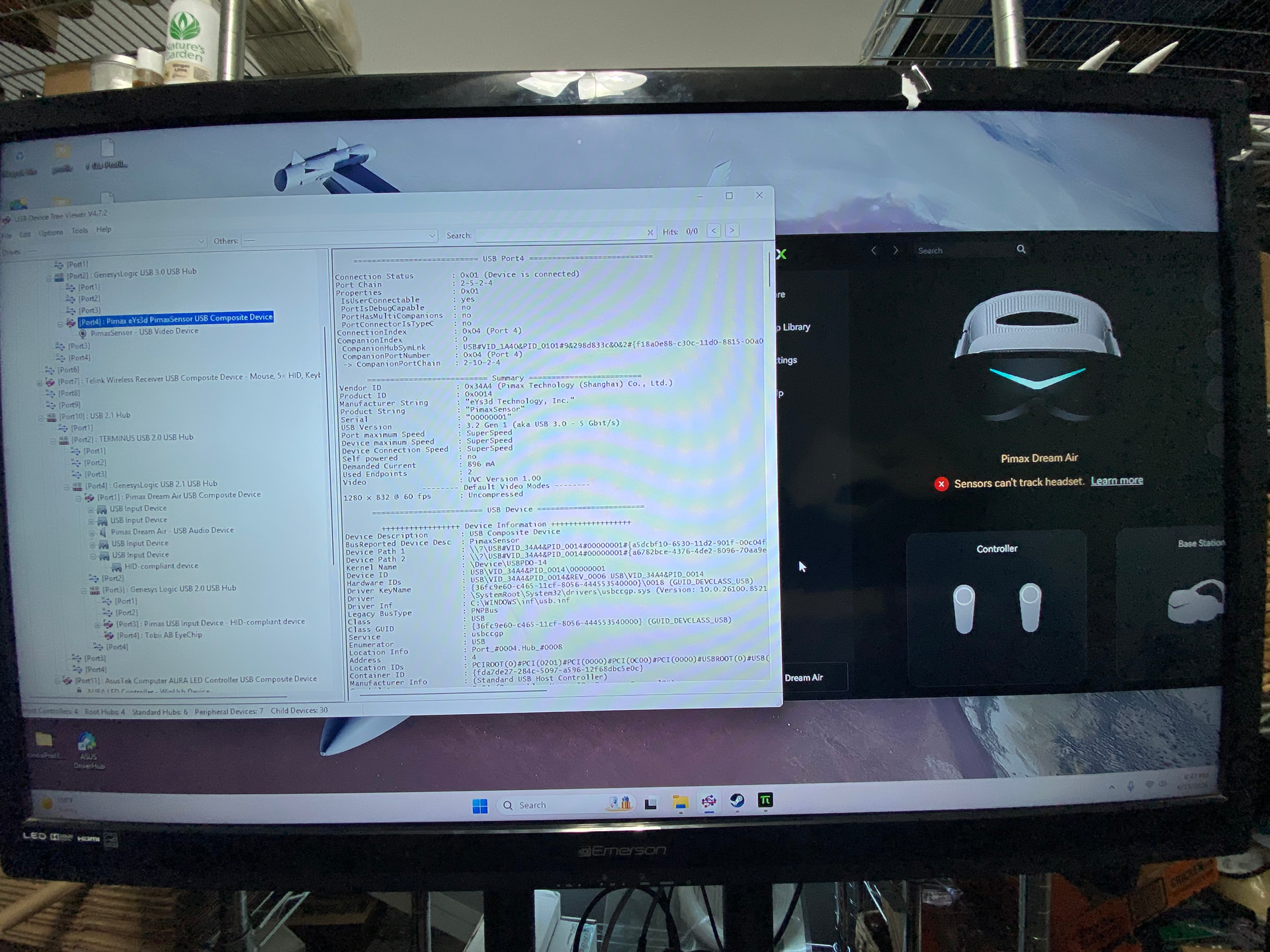

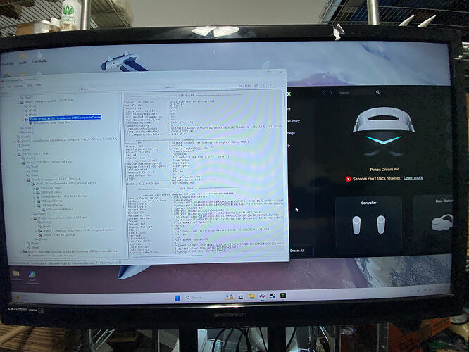

this image shows that the dream will not find the USB 3.0. However from the usb tree you can see that its on 3.0. So i’m not sure what is going on. if any of you see something or think i need to perfrom a test let me know. right now i just have a expensive brick
things worked fine for me when i first installed everything. then the headset wanted a update and after that thins worked 1 time, after i came back the next day nothing woudl connect or work.
not sure what the issue really is.

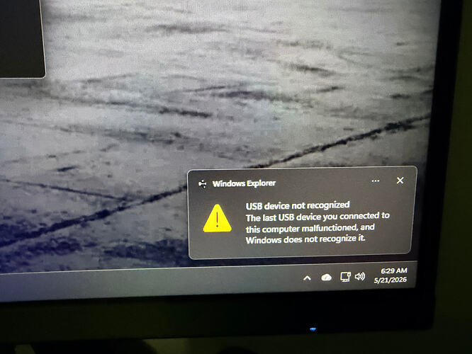

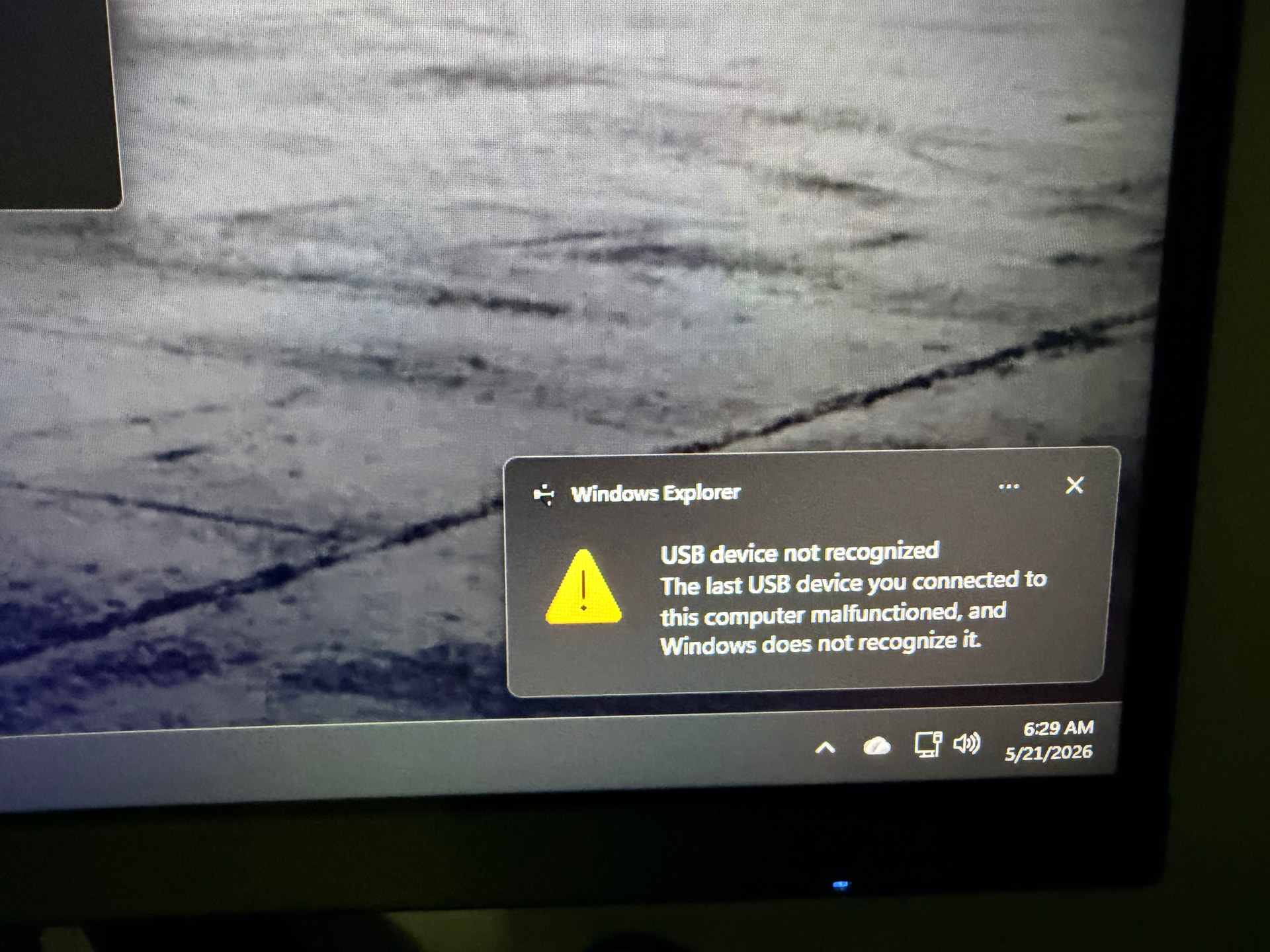

Did you get any of these errors? My first Dream Air basically died after the 1.0.2 update on 1.44.1 update right after I got it and plugged it in. I troubleshooted it for about 4-5 hours on my end and tried it on another one of my PC’s and both PC’s it gave me a USB error and wouldn’t work. Submitted a ticket and got approved for an EMA pretty quickly after I overloaded them with my troubleshooting efforts and it took about 10-12 days to get another Dream Air headset in. My 2nd Dream air works great so far after about 2 weeks of use.
so no errors like you showed. just the one in my image where it says the “sensor can’t track headset”
when you click on “learn more” that is where it says i need to connect to a USB 3.0 which i think i have shown its connected to.

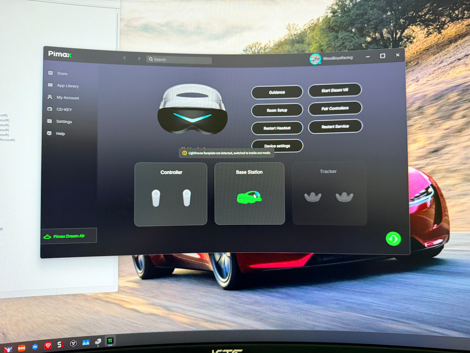

one thing i did notice on the new headset is that the “desktop” and toolbars inside the pimaxplay 2.0 app seem to be a little bit blurry. i understand you can change the desktop screen res that helps in desktop view, but nothing clears up the toolbar.
Also the home screen is a bit blurry too. Is this normal?
Blurry? Is the QV enabled?
