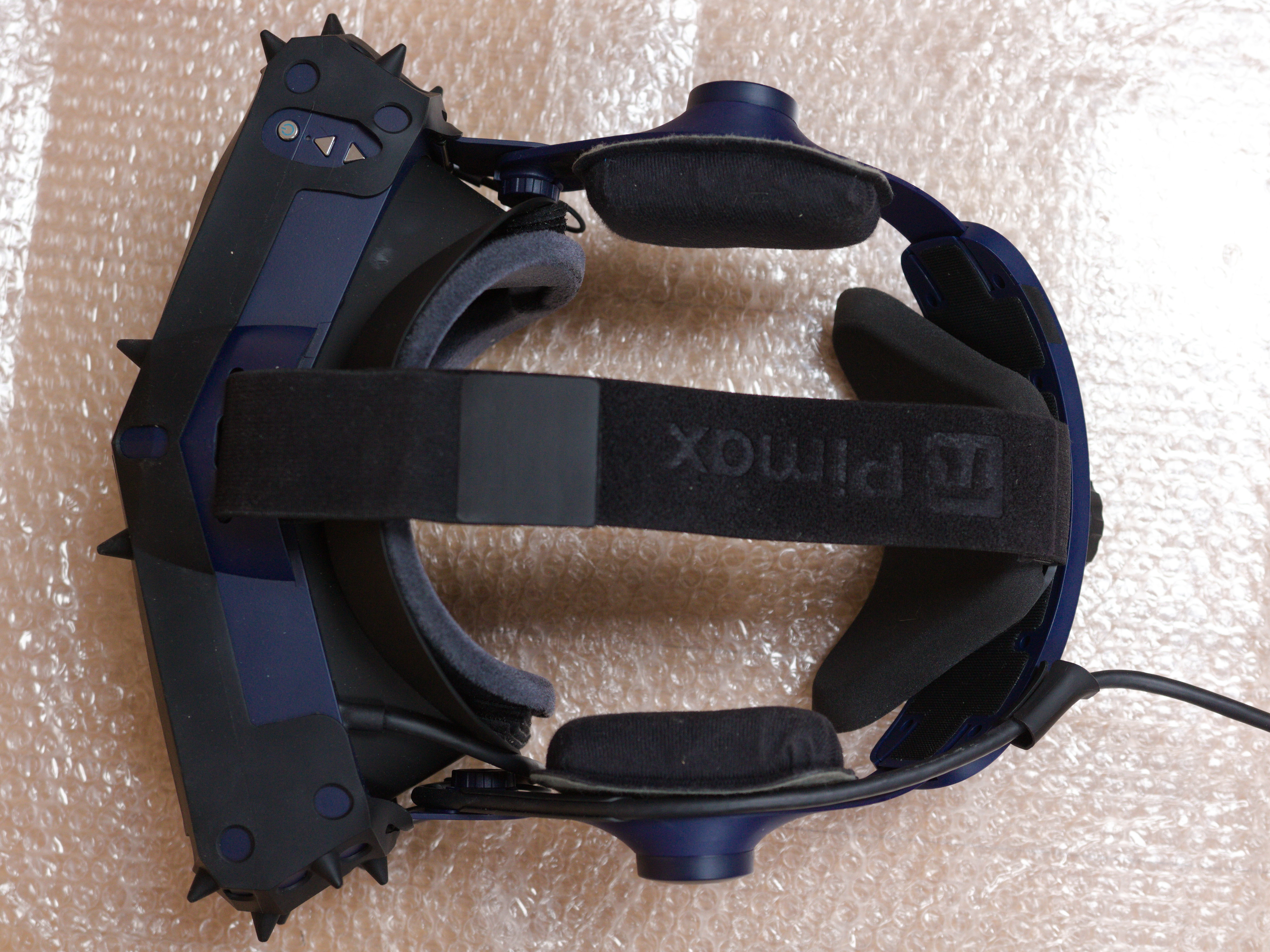

please suggest your team to include a an optional standard, “cheap” Velcro headstrap with every HMD in addition to the (D/S)MAS already attached.
Reason:
I am cockpit-sim-VR-player only, playing 100% seated in my chair.
With the MAS, I cannot lean back comfortably due to the knob - which wouldn’t be too dramatic for me if there would have a been a simple Velcro headstrap (used i.e. for the 5K+ already), I could have fixed quickly to the 8K-X instead.
… fortunately, I had my 5K+ still, so I took its Velcro headstrap and attached it to the 8K-X. Since then, everything is perfect for me :+1:
But in the first instance, I was quite annoyed, and I would have been even much more if I would not have had that Velcro from the 5K+…
I am sure, the 5K+ -velcro just costs a couple of dollars in maximum, probably less for Pimax if purchased in large quantities.
So please include one - optionally, additionally - with every HMD - I am certainly not the only one who could not use the MAS while playing seated.
(PS: And any sound option on the headstrap doesn’t bother me at all since I am wearing my headphones anyway.
So Velcro is just fine for me :slight_smile: )
