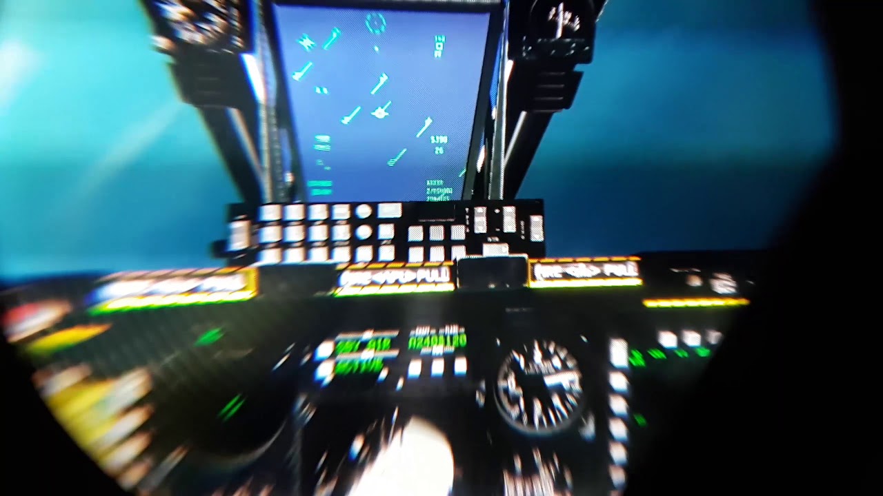

Okay, let me add something here, as I see some some are starting to get confused and mix completely different things, or take the example of CRT screens, when the problem is just different on different screens.
CRT screens worked in a completely different way than current liquid crystals, cathod tube was fast but the excited elements from the cannon on the screen (pixels) had a short persistence, even if they were updated at high speeds, that was the resulting primary flicker reason they had at the time.
Let’s leave the older CTR monitors of the home computing era, because they were just Tv’s with very low refresh rates and even used interlaced PAL/NTSC screens; the lastest flat panel models got as high as 100Hz at SVGA resolutions, but it is not important anymore, since these have now phased out from the market completely today.
On the other hand LCD work in a completely different way because they are not really refreshed continuously, liquid crystals mantain their state, and just transition to a new state when called to change, this is a good thing for displays who don’t have many fast changing pixel per frame (good enough for watching Tv or Movies, but not for fast paced games like racing games etc.) , but the problem lies in their much slower transition time speed, and they can’t really go as fast as the current gaming would require, hence the various techniques applied to “add” more frames or alternate black screens to pump out more “supposed” frames, but this doesn’t solve the problem, only tricks the user perception to see a smoother image and give the impression of more frames.
This is why almost any LCD screen is going to show the alternate grey light and darker bands that are clearly visible in the pictures I have posted, that are scrolling up or down if you watch a video taken with a fast enough high end shutter speed camera, this very fast strobing effect is not noticeable to the naked eye, even to most trained users, but the user brain is perceiving it, in any case…

Now, knowing the above, please try to keep the focus on the problem, as I see some are still not grasping what we’re talking about…the problem is NOT that some humans have the ability to detect flickering/strobing images while some others don’t, it has some significance to understand what we’re talking about but does not point out the problem itself, so the Pcgamer article has almost no relevance here and can even lead to diverting attention more than being useful. Yes, some people, like avid and experienced gamers have a more trained eye to detect differences in refresh rates, ghosting, tearing effect, stuttering images etc. but any human being perceives these things on an unconscious and subliminal level, and if some experience nausea it has nothing to do with their being worse than others but rather that they are better picking up the warning messages their body is sending them, so…just like some military are adapted and trained to sustain very high stress levels and keep the concentration and focus on the target, some people will feel no effect, but the downside of this is that they will not be aware of some input information they are subject to.

It’s the same problem I’m talking about, the difference can be easily noticed here:
This guy had not used a very high speed shutter camera, but the effect is clearly noticeable in any case.

The strobing is indeed intentional, and a good thing, that is used by both Vive and Rift, and black bars across video is an artefact of the rolling shutter of one’s camera (EDIT: …not matching the rate of that of the display, or in this case, the rate of the global refresh of the display).
Why you think it should be a good thing ? I’m curious why you think so.
The artifact only appears if the camera shutter has higher speed than the panel refresh rate, if it is the same or close it doesn’t appear at all, like in my Oled TV picture, where the exactly same camera at 100fps/Hz was used, like for the other IPS screen pictures.
Also, why on newer panels like the Odyssey it is almost not there ?
If you have full persistence (i.e if every frame is visible the full period of time, until it is replaced by the next), you perveive the noticeable “jump” in motion across the screen, between them. This comes across as “judder”: Your brain expects continous motion, but it comes in discrete steps, and your perception gets screwed up - a sprite will appear to “jerk” across the screen instead of moving smoothly, and ghost at the the edges. The ghosting is completely created by the brain, and becomes doubly problematic in a VR context, when the screen is stuck to your face, and you get to look around, with the picture having to update the view accordingly - you turn your head, and the view moves along, rather than staying behind, being, as it is, the virtual world around you – a major cause for nausea.
In lieu if having to render hundreds of real frames per second, to produce full proper animation, strobing is a good workaround; Your brain will assume things move along between “flashes”, when the conflicting information is removed (EDIT: Think of it as the temporal equivalent of what you have spatially, when you pixel a slanted line using only dots, spaced apart a bit, rather than contigous – the latter will proudly exhibit its jaggies - for the former, your brain just thinks of it as a straight line, albeit dotted). As long as the flash rate is high enough, you will not notice the strobing, and your retina will receceive the same net amount of photons over time, as with persistant light, just like you do generally not with good quality LED light bulbs. (Volvo cars from some period of years had rather low strobe rates on their rear lights, which you may have noticed if you have ever been out driving behind one at nighttime, and possibly been a bit tired as well: Unpleasant POV ghosts of the things sticking to your retina, when looking around - especially in one’s periphery.)
The judder is a problem that was introduced with LCD screens; Unlike the CRTs before them. whose phosphor excitation would decay well before the next field was scanned out (the flicker was not in every way a bad thing), they were driven with capacitors, that hold a charge, to keep their state stable, producing the flicker-free greater persistence. Remove the capacitors, and there is no reason you wouldn’t be able to directly PWM a LCD at good rates, just the way you might a LED. Not that anybody does it, afaik, other than digital holographers.
There is less… hmm… “banding”, the closer your camera rates matches your display, yes, but it does not just plateau and end – you can still be out of phase with the screen above the matching frequencey, and then it becomes a matter of both the persistence of the display, and the exposure/shutter speed setting of your camera.

Perfect !!! I agree on almost all you explained here, it is basically correct, but you have to also consider that all this has been done to compensate the latencies and disavantages of the LCD and Led’s used for backlighting them because they are too sluggish in any case, and this mostly applies to these panels only ! We can not even talk about persistence in these panels since it is continuous, it is the transition that is so slow and need all that you explained (and more…) to eliminate the judder.
Yes but it is not a matter of persistence, since LCD don’t need that, but about TRANSITION. And it also proves that the LCD panel we’re analyzing has a slower refresh than the camera shutter, even if the panel manufacturer declares for example 90Hz, in reality there are no smooth transitions from one frame to the other at that “declared” frequency because most of these panels can not switch at more than 60Hz, real frames, CLEAN FRAMES x second.
What I’m saying is that this strobe created for the LCD’s unfortunately introduces another type of problem that is not consciously perceived by the user; in the end it is not a problem for the casual user or gamer who just want to play and don’t give a fuck about everything else, but the true story is: it affects the brain in a unhealthy way.

Hmm, try the other way around. The slower your transition times, the smoother the in-place transition, producing ghosting that actually happens on the screen, rather than the “in the viewer’s brain” one, that I mentioned; They are not the cause of judder - that is having full persistence, although they are the cause of aforementioned temporal smear, which, as you suggested, we do not want to have to watch.
That the strobing masks these transitions, is more a happy side effect than anything else, certainly not the fundamental reason it is implemented, which is, again, to deal with the persistence issue, and its resulting psychovisual “judder” effect.
These slow transitions are such by design, basically implemented by engineers stuck in an analogue mindset – the actual transmissive liquid crystal materials can transition much, much, faster, when the driving circuitry is not deliberately made with latency incorporated.
So the strobing thing is independent of the display technology – the very main reason we got OLEDs in the Vive and Rift in the first place, is that their rapid transitioning made strobing possible - without needing to rewire any backlight, much less any active matrix drivers.
Today we have LCD panels where we do have better control over the LED backlight (rather than older and less responsive CCFL), even if the active matrix remains sluggish and analogue in kind, making them a viable cheap alternative, since we can strobe them, just like we do already with the OLEDs, and consequently also have global refresh (as opposed to rolling shutter, with a full frame that is snapshot in time, and can not adjust on-the-fly for your head movements, while the refresh scans out), just like with them.

Transition, you should see not as a black band, but as a crossfading gradient (thankfully, I suppose the strobing got rid of that).
If I have a 60HZ rolling shutter monitor with less than full persistence, and a camera with the same, and end up so unfortunately synced that the camera leads the monitor, I will get just a black screen in my footage - if the monitor is 120Hz and still low persistence, I will get the effect of the monitor raster scanning twice in the time I’m capturing (scanning down) one frame; Persistence matters, and having a display that is speedier than one’s camera does not necessarily mean I’ll get a flawless picture.
