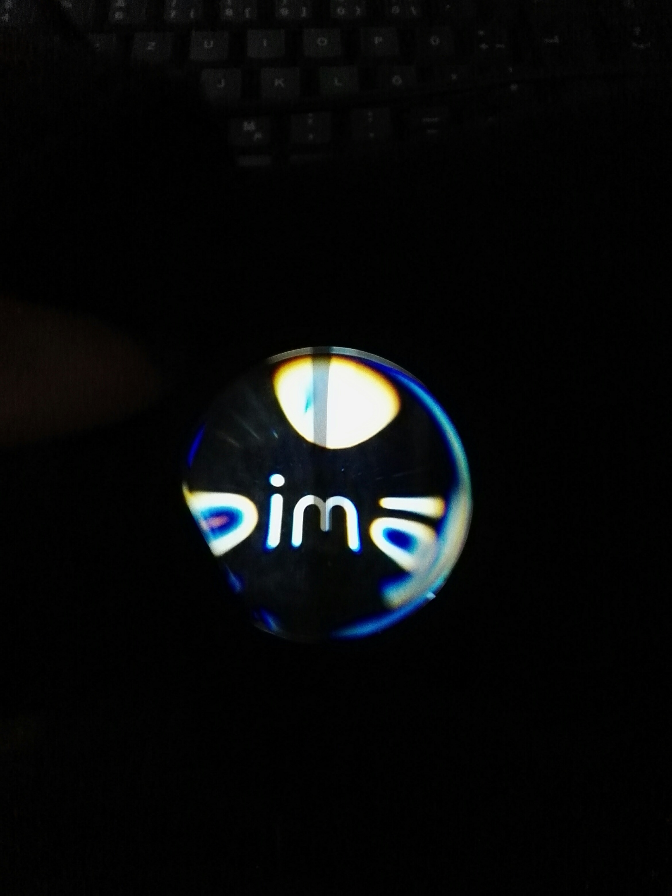

Yay, just received my 4K HMD today and guess what? It seems to be faulty. =(
At first everything seemed to work -relatively- fine, "just coudln´t use video mode because in video mode the whole picture was vertical and looked pretty strange (rotated by 90° I guess).
So I switched back to pimax mode (had to drag the open piplay onto my actual desktop screen…
After just like 5 minutes, while configuring Steam VR, (probably after taking the hmd on and off my head) I noticed a black bar on the right eye/lens.
It seems to vary on the actual picture though.
In some ocasions it seems that this vertical bar ist suddenly just a much brighter (backlighted) area of the screen, then again it appears to be just a dark strip.
Any chance to troubleshoot this without waiting another milennia for it to arrive from Asia?
Thanks in advance for any replies!

Please take a photo about this issue to support@pimaxvr.com directly, it will be better for our further estimate, thanks.

So here it is.
Unfortunately there already is the newest firmware on this device.
The manual firmware upgrade didn`t work at all, because several .dll files are missing. But I guess reflashing the same firmware shouldn´t do anything. (?)
