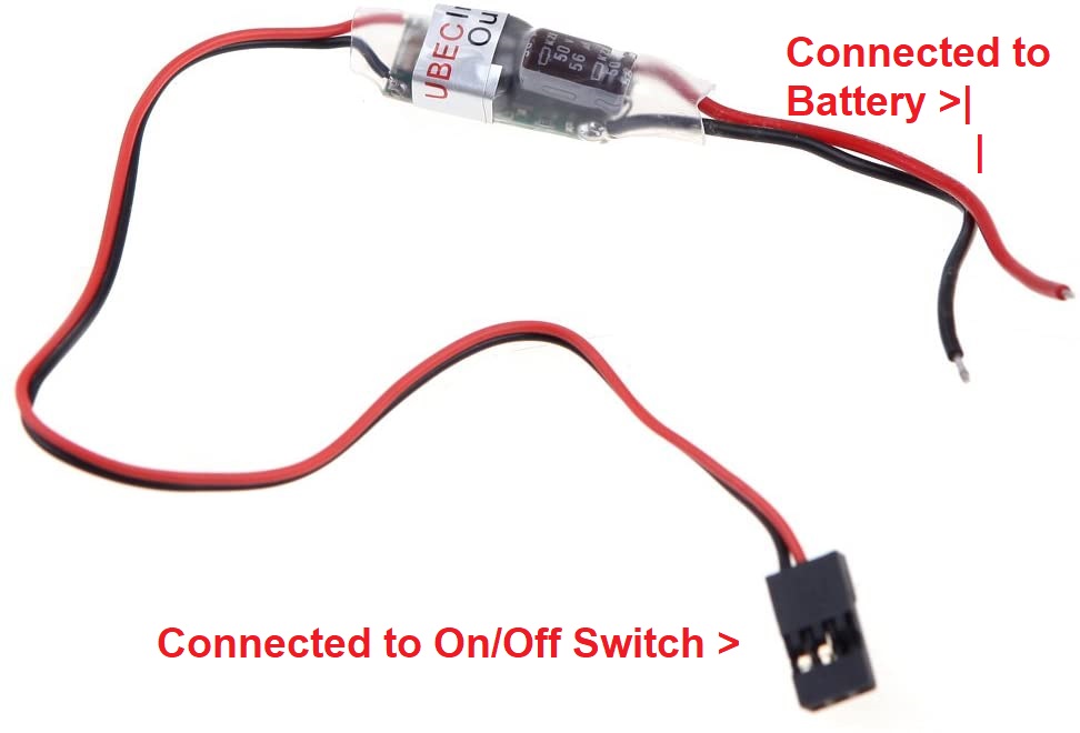

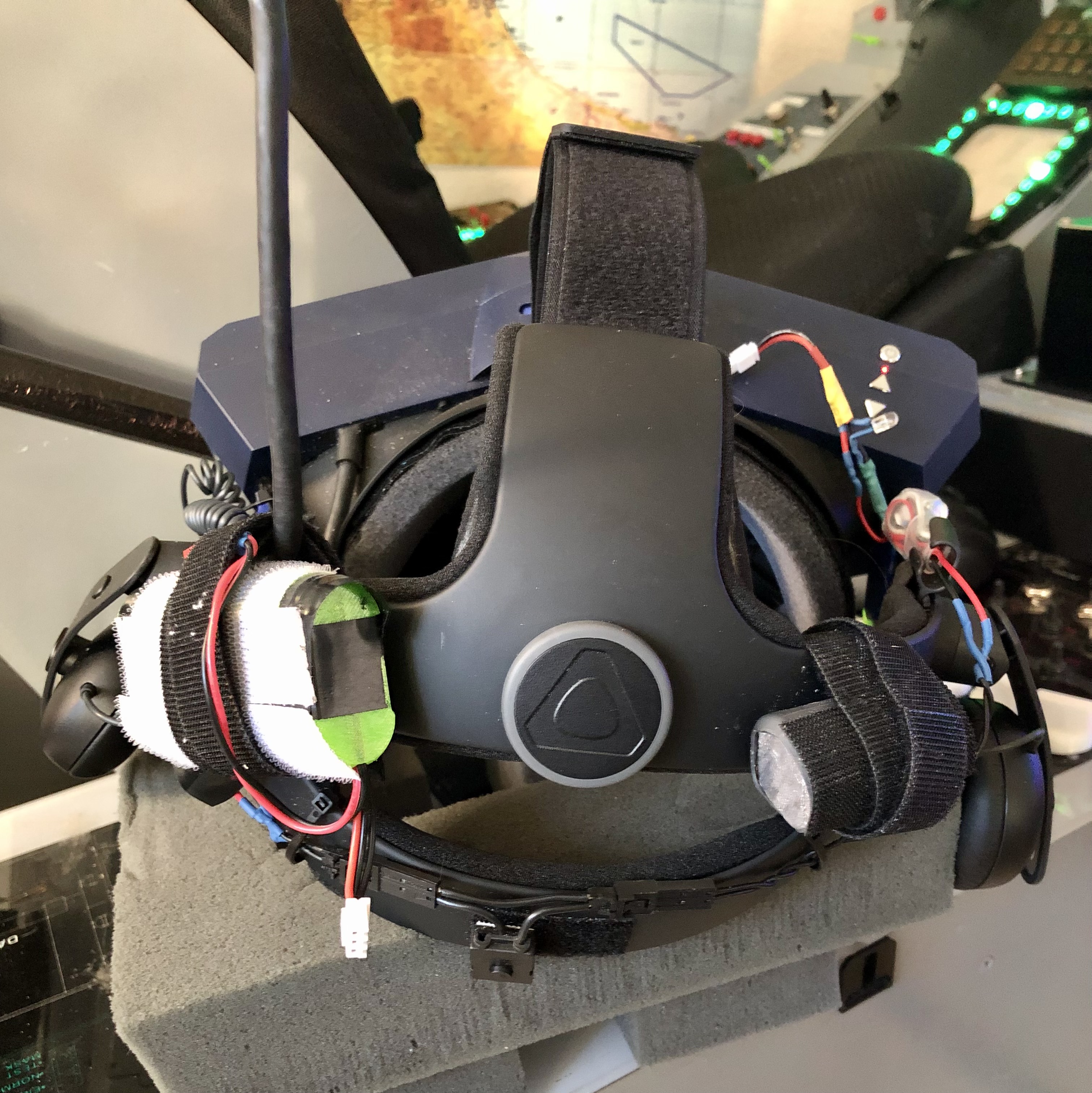

As far as recharge batteries, get two cell lipo (3.7 volts each) and wire to a 5 volt BEC with a switch before the BEC. A couple of 18650 cells wired up last a very long time. You can do it your self or buy something made already…
Use any 5 volt BEC

I’ve got some questions. Want to configure it where I can swap the battery out that’s connected to the BEC or I might go the USB power bank with on off switch route like @Djspyker has done.
So it’s Fan > 2 pin Female wire connector > On/Off Switch > BEC > (2 pin Female wire connector > 7V Li-Poly battery
Is this correct?
What is the proper name for the white 2 pin wire connector that plugs to the fan as well as the battery?

My understanding of the BEC connections:
The reason you want the switch between the BEC and the Battery is because the BEC will have a little bit of draw on the battery. So I would connect the switch in between the battery.
I build racing drones (fixed wings and quads) and E-bike batteries so I had some extra 18650 cells laying around. I 3d printed a case and wired them up myself.
Your POT links show they don’t go below 5volts and you do not want to exceed 5 volts so you would want something that would give you say 3 volts to 5 volts I believe. But I do not use a POT - I just run the fan at 5 volts as I need that much airflow to be effective.
I also did not use a USB connector - I just went from the battery pack -> Switch -> BEC -> Fan (LED in between)
The milli-amp draw is how much the Fan will draw at 5 volts which is pretty small. I have run the fan for serval hours before recharge. You do not want the 18650 cells to go below say 3.2 volts per cell (6.4 volts for two cell).
I use the two cell 18650 as the left counter weight also . . .
The white wires must be some type of signal wire (not sure what they do) but I only use the Red and Black wire. Some RC (Drone) BEC use signal wires.

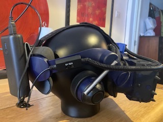

I disconnected the USB cable going to the computer and plugged in a powerbank to lighten it , as two cables is heavier. The fan is loud but the speakers overpower the sound while playing.

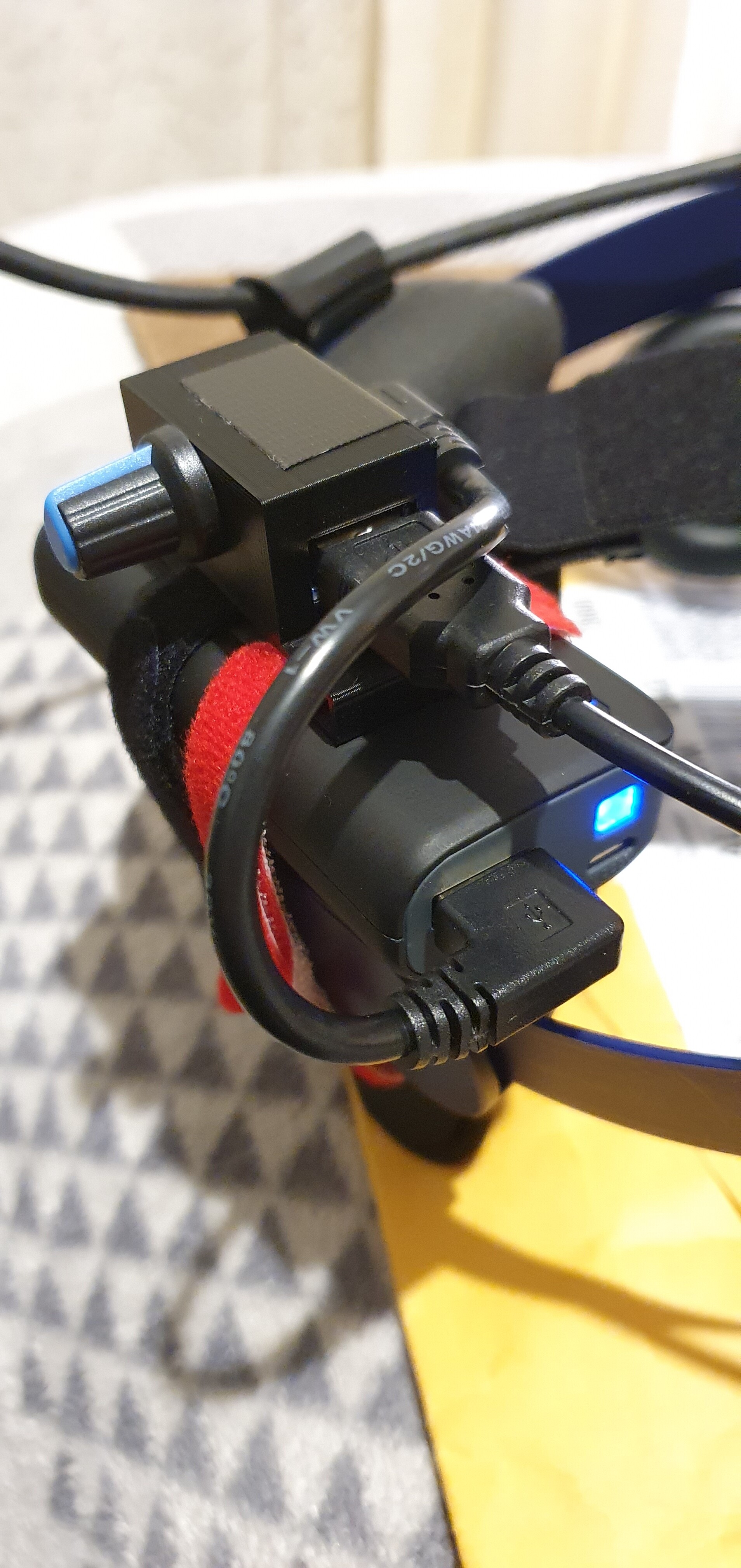

Changed the battery to a bigger capacity and added a USB speed controller.
