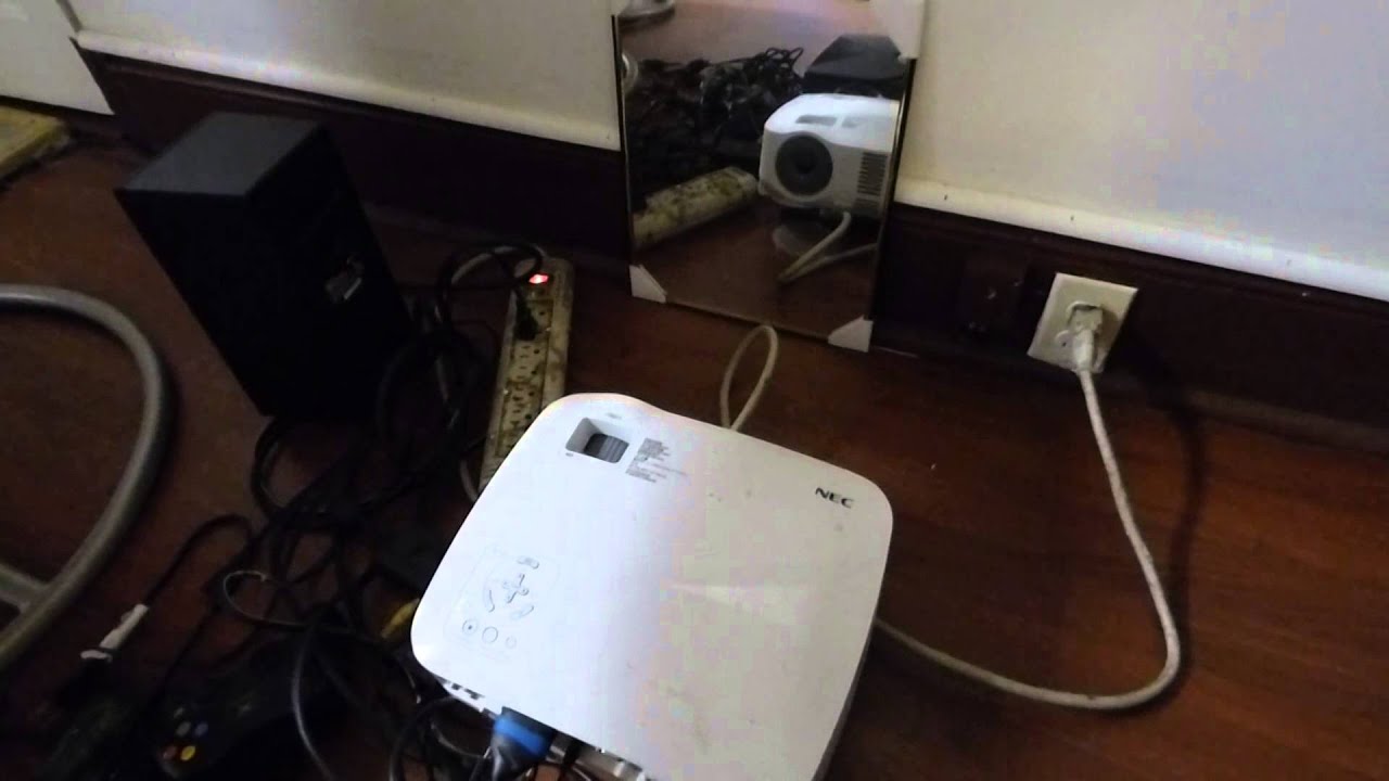

I had just been thinking around whether a few mirrors might be able to turn your projectors into short throw.
Do the mirrors have to be a certain way?
I was thinking of using mirrors to mount the projector above the wall it projects on, just like the ultra short throw ones. Possibly using 2 mirrors, although 1 is possible.
As long as your projector can display reverse image (most do I think) then no special placement of mirrors- just got to line them up the way you want to display. Correction of display angles can again be adjusted at the projector.

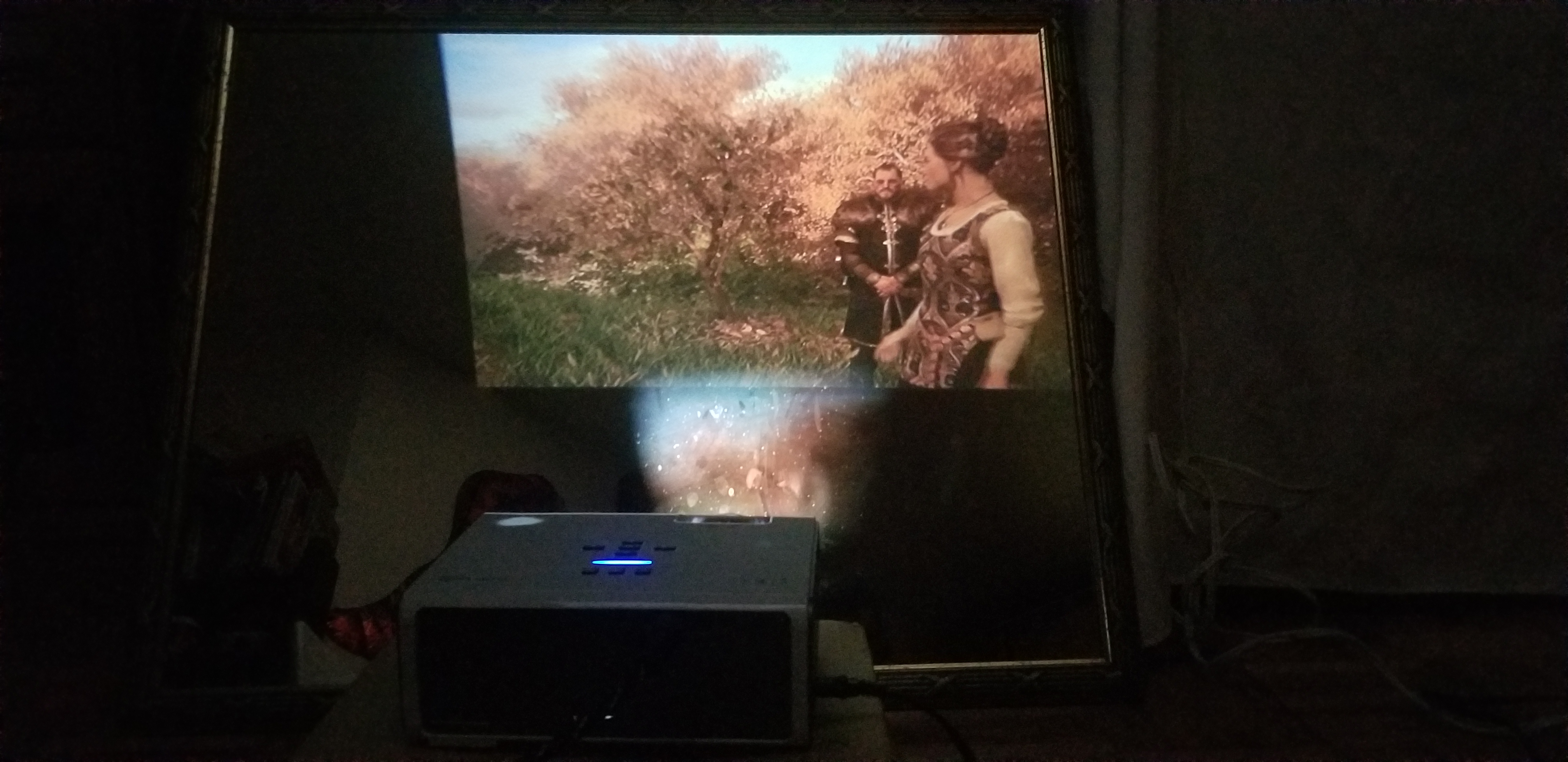

I think i have great news guys!
Like you guys suggested, using a mirror, i can solve the problem ![]()
Look how close i put the projector in front of the mirror and look how big the screen has been projected on my ceiling
The cealing of my house is not smooth, this is why we see a grainy pc game image
At this point i think i can actually even leave each projector on the floor, right in front of a mirror positioned (each projector would have their own mirror) right in front of the projector panel
As soon as i get the stands i will test and let you know ![]()
Thank you so so so much , guys !

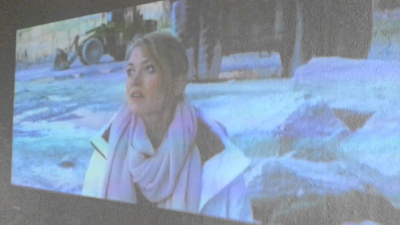

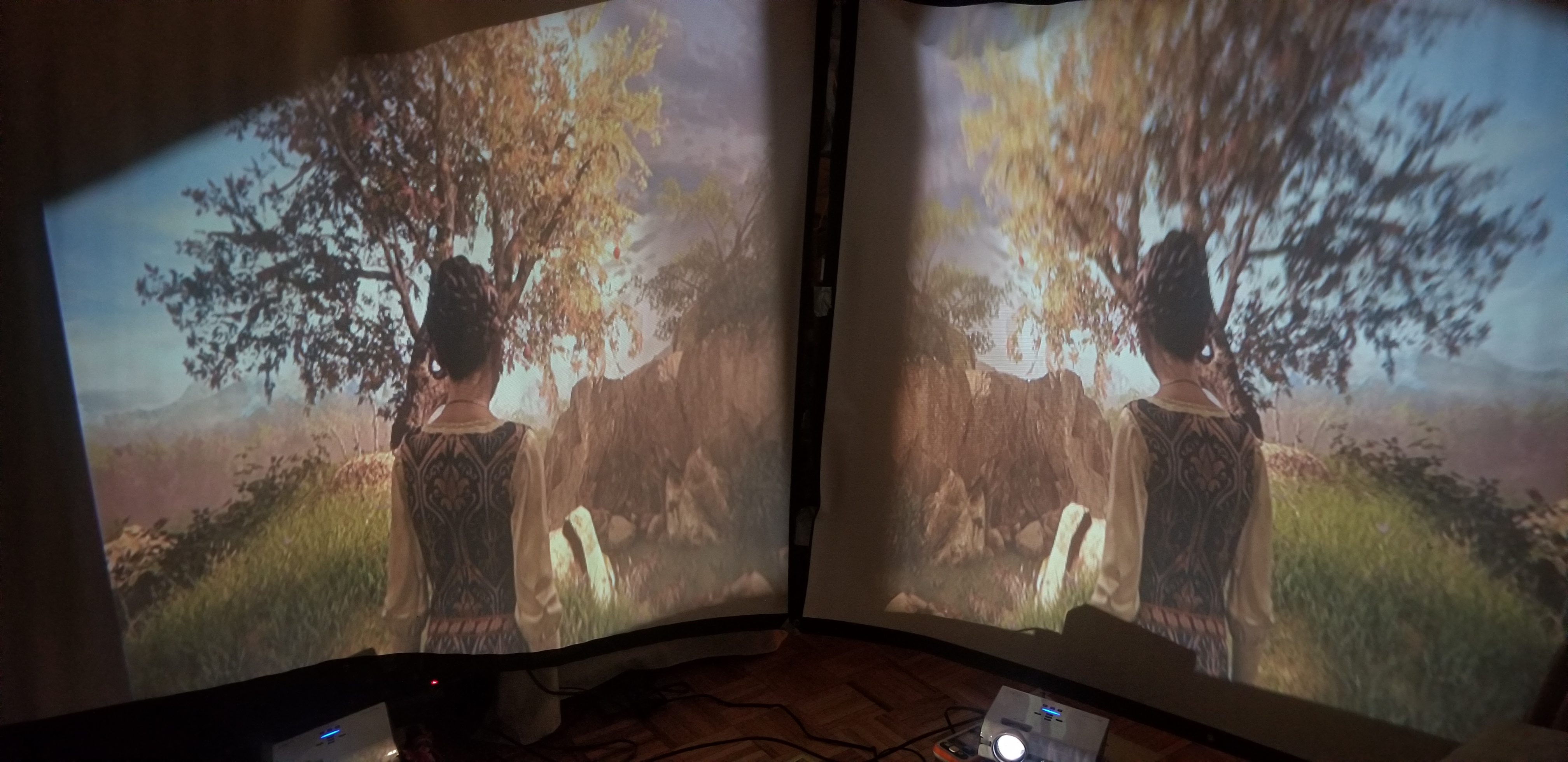

Some more testing .
I have used just 1 mirror reflecting at the same time the same image projected by 2 identical projectors .
I have forgotten to flip the image on 1 of the 2 projectors, so you see the lady looking at opposite directions while she should be looking /facing in the same direction.
Also the next step when getting the panels holder is to lift the panels to have the projectors emits the light from underneath the panel and the mirror would be closer to the panel and reflect the projector light into the panel.

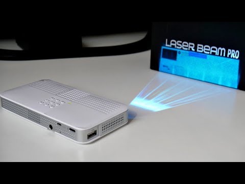

Perhaps this tiny projector?
You could potentially use one of these for a good mirror to mount. If you remove the padding from a helmet there would be plenty of room for cooling, and to house the micro projector.
You could even use this as opposed to the mirror I linked above to get a mirror inside the helmet at the optimal space/shape needed, but with no added hardware or weight. The projector doesn’t even need to have a high luminosity, because it would be within a helmet.
