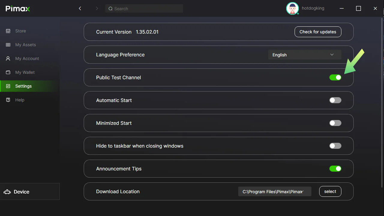

Have you tried the 1.37v version of Pimax Play?
You can update to this version by enabling the “Public Test Channel” in the settings tab of Pimax Play.
Wow, it is working good with latest steamvr! Good job ![]()
