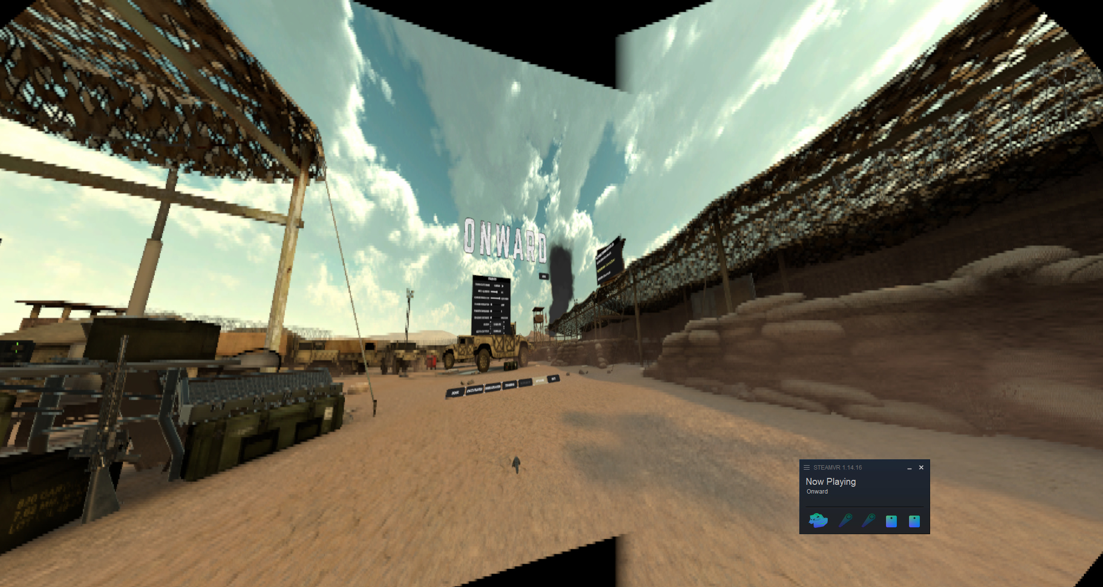

ok its still doing in in onward the right eye goes blurry , anyone elss getting anthing like that in any other game . im using the beta drivers now

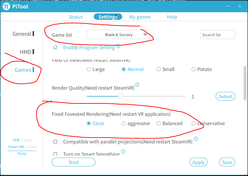

I had this same issue in Elite Dangerous after reinstalling windows. After a lot of searching and testing, it turned out to be the combination of having Fixed Foveated Rendering on in PiTools, and also having any form of anti-aliasing on in the game. Turn off either of those, and I was fine. Note that I had to turn off the AA in the game’s video settings, changing the settings in NVIDIA control panel didn’t seem to do anything.
ill have to give it ago as i just found another game its started doing it in weird thing is the menu was fine but evetime the game started bamm one eye blury , and when the game ended and went back to the main menu it was ok

It’s in PiTool or Pimax Experience and it’s a game-specific setting. I have the problem with FFR in Boneworks and the latest v8 of Blade and Sorcery which I just installed (wasn’t a problem in v7). Haven’t tried Onward in a long time, I didn’t used to have a problem but maybe on a newer version.
Games -> Game List (eg Onward or B&S) -> FFR -> Close (which means off)

i know it’s a silly question & as I have no X myself & saw a lot of complains that right eye not in focus, just wondered did all of those ppl experience real optic problem or it was FFR as on first picture it was obvious for me that it’s FFR. On other hand for 2nd eye & optic problem other ppl could experience next things:

Oh yeah, massive difference between blurry eye due to lens / lack of focus issue, and total pixellation in one eye, due to FFR issue.
