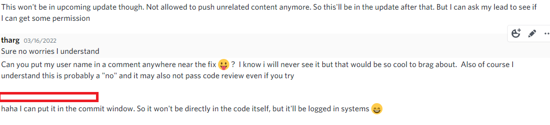

I am told that a fix for this will be in After the Fall in the next “proper update”. Also there was a small related issue with the “screen fade” not applying to a part of the screen that I am told has also been fixed as a part of this.
@MagiJedi reported it in their discord and I chimed in to agree, and I showed it in a vid to one of their devs and now he tells me he has it fixed.
Also lol :
E : Also their QA team has a Pimax now, which is great.
