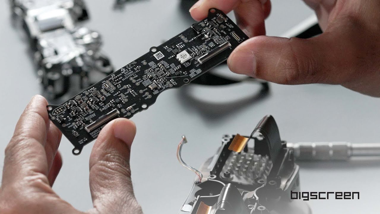

BTW, do we know that the factory set personal IPD cannot be adjusted DIY?
Surely they have a standard mold with rails that are spaced as per the user specifications and then fixed to their position? If that is done with a screw rather than glue, adjusting the IPD DIY style should be absolutely doable.
Or is the issue that the physical settings are somehow baked into the fw per device, hence reporting a fixed IPD value to whatever API?
Darshan talks about it here at 8:10
Oh i’m pretty slow on the uptake here (sorry), so the ipd is set at the factory? If that can’t be fairly easily be changed by a user then that’s a major negative imo. I just thought it was the facial gasket that was made individually.
Yeah the eye boxes are fixed.
It might be a step too far when you look at how well the Pico 4 and motorised IPD adjustment works.
If Byte Dance only made a Pico4 Pro with 3k OLEDs.
One tend to imagine tooling and stocking of the multiple variants must contribute non-negligibly to the price, and that having a single frame with a range of slots for optical modules to plug into, shouldn’t have had significant effect on weight, bulk, or rigidity, but hey – it’s easy to armchair-engineer… :7
Given BigScreen share all the CAD files, apparently, I guess a more tinker-minded user could adapt a BSB for a new user, by 3D-printing the appropriate substitutes for its original frames…
Given the rough milling-like surface structure on face masks seen in videos, I’ve been wondering whether the silcone facemasks are maybe cast in 3D-printed moulds, which strikes me as the simplest one-shot manufacturing solution – face side down, and the frame with the magnets slotting in up at the brim, prior to pouring…
I wonder, then, whether the user gets the .stl for their personal face mask, along with it. :7
