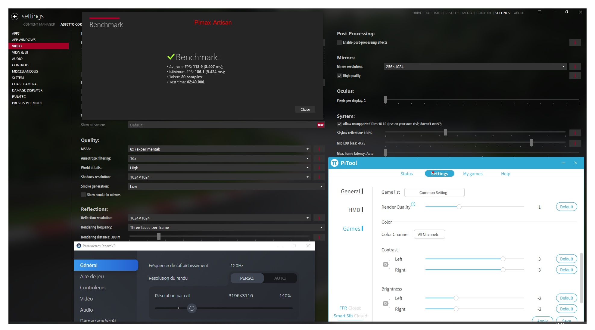

Here are my benchmark results with Assetto Corsa with the same same settings with Pitool 255 at 120HZ with normal FOV on both headset. A back to back test and the second test with my 5K+ had a better average FPS result.
