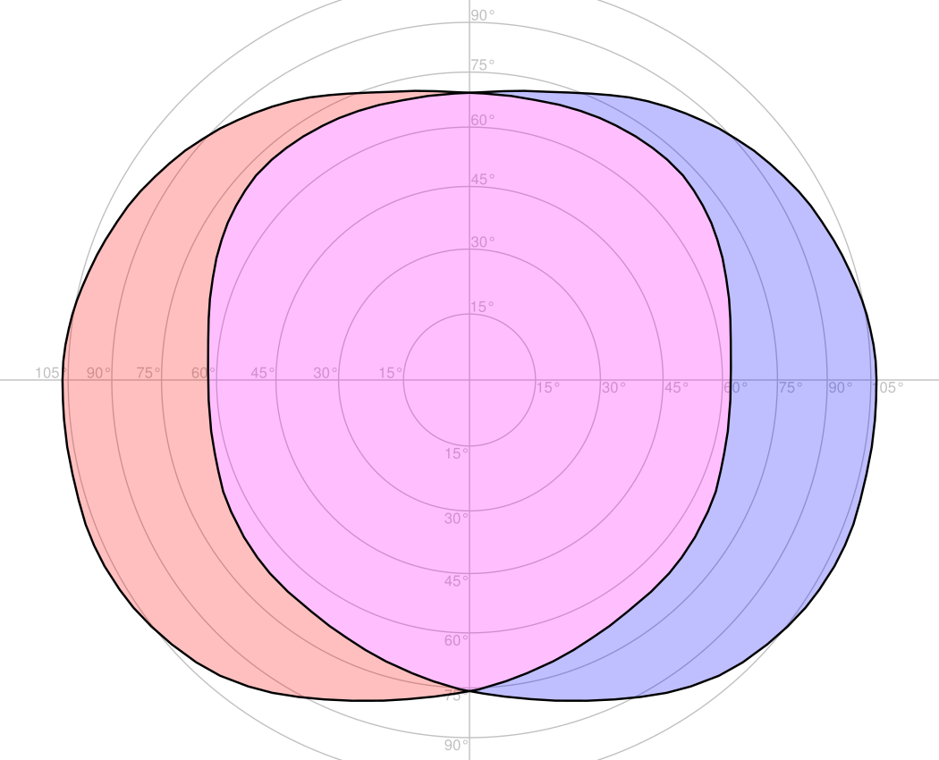

For optimal MAX (optimal is quite subjective) Fov - optimal lenses distance to pupil you say there is minimum distance passing which you will get something wrong (distortion? cut rendered FOV? eye strain?). And according to this sphere representation at radius 1 which was shot by one camera (indeed it can be helpful to get related comparison between headsets using the same method & tools) but there are lot of variables & a places to do a mistake like the point he points hist camera at the lens (sweet spot can be different for different lenses), stereo overlap calculation, how he mapped camera output to the human fov project picture & the rest things.
So e.g. let me provide an example what doesn’t work for me:
according to this picture common stereo overlap is about 120 degrees, a bit bigger,
Ok I closed left eye, found with my right eye the left border, put there an object IRL, did the same with my other eye & got about representation how big the 120 degress picture is in human FOV.
