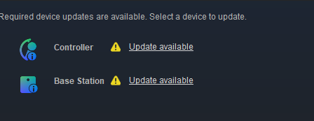

Oh I may have just been impatient. It seems to be “working” now.
I just plugged in an index controller to verify that the HMD not required setting had worked, and this popped up
![image](https://community.openmr.ai/uploads/default/original/3X/b/6/b6e7e2cf7c59335c5c322d51e464a2e0a7c3b8f5.png)
So either the controller triggered it, or I just needed to wait longer.
Will now try updates to see if they work.

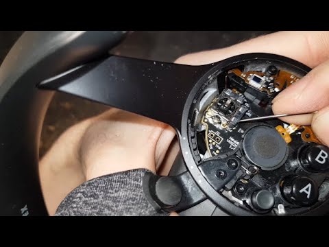

Well ya that is definitely hardware and not firmware. It’s not like they haven’t had clicking issues either.
It looks like the internal mechanism fell off alignment. I mention that having had an issue with my first stick not moving all the way forward and instead of centering, it would drift backward. Fell off a lit of ledges.
I did surgery on an Oculus Touch stick. The top screw holding it’s stick in place was also keeping the central mechanism in place. When the screw got loose. Once I re-seated the part that was loose and tightened down the stick it was fine.
If they don’t resolve your complaint you could always look inside at where the stick sits but care with the ribbons,
[[Album] Index Controller tear down (almost) ![](https://i.imgur.com/JNcC7hL.jpeg?fb "Index Controller tear down (almost)") ](https://imgur.com/gallery/cxzwi99)

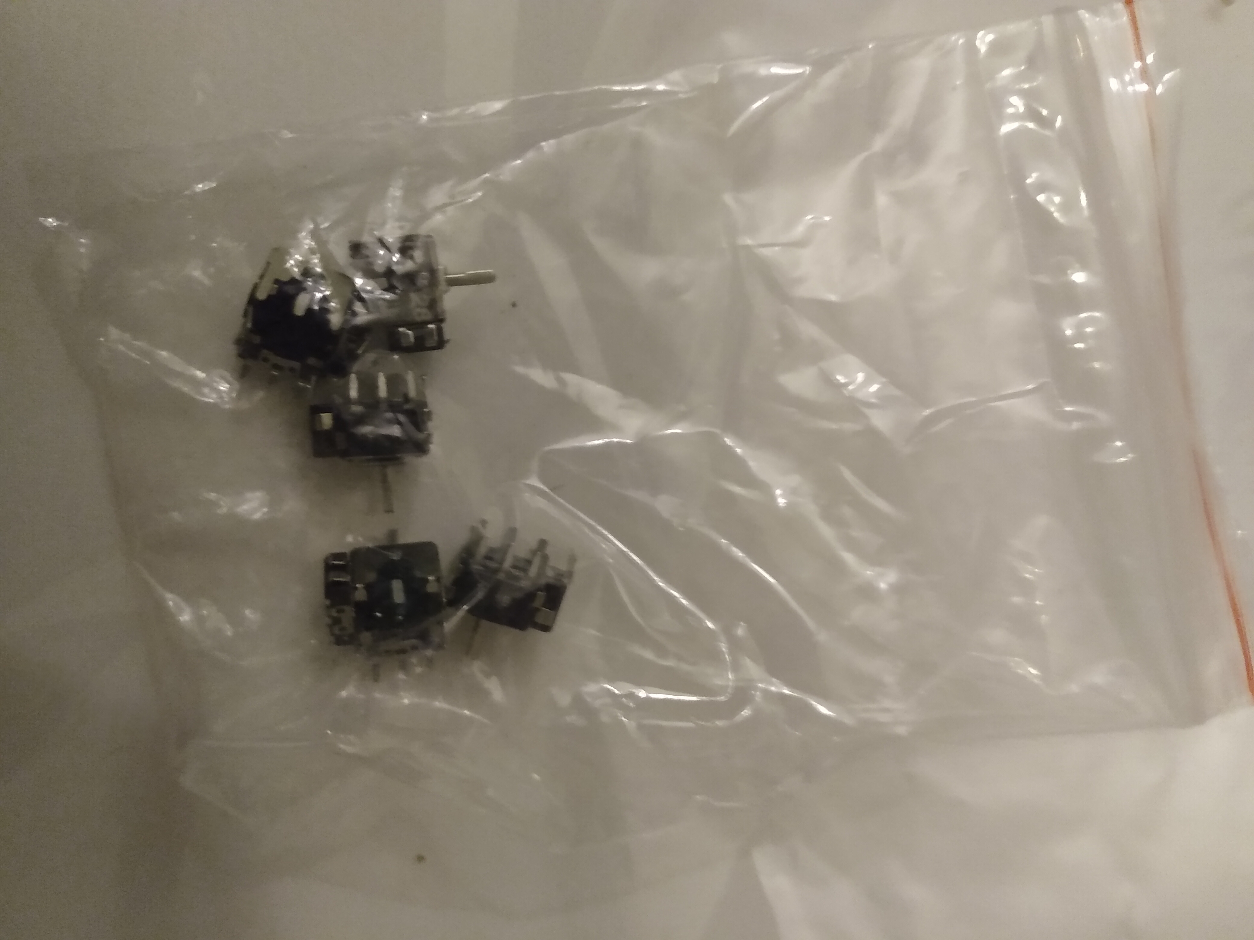

Due to a weird sequence of events I have a third set of index controllers that also have the issue, but they are not under warranty.
I also received these
 ![image](https://community.openmr.com/uploads/default/original/3X/6/2/62bae26b202a15f1a10d69aa433e1c911a504c0e.jpeg)
today, have the this vid
[![](https://img.youtube.com/vi/s4R7GnDEV5o/hqdefault.jpg "Замена стика контроллеров Valve Index ( стик FJ06K-S )") ](https://www.youtube.com/watch?v=s4R7GnDEV5o)
in my bookmarks, and a few spare hours this weekend.
