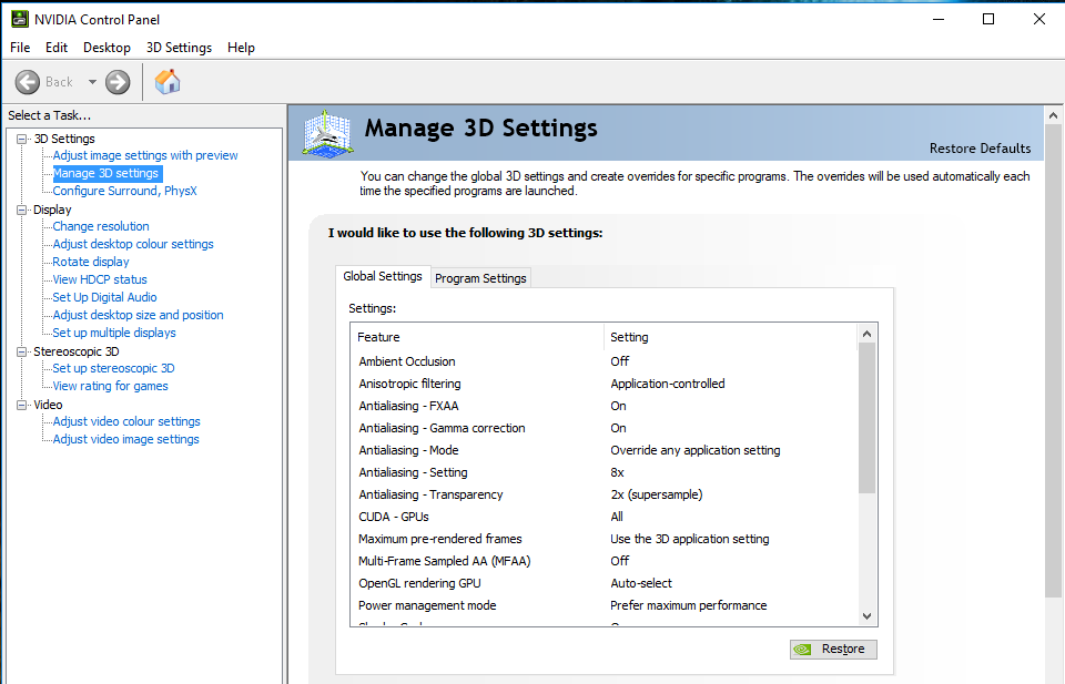

1 thing i forgot to mention … in your nvidia control panel… try these settings
see if they help with your fps? - you might find it helps on a few more games as well like IL2, DCS etc.

maybe you can post your settings , the same way i did further up! steamvr, nvidia, piplay and in game settings etc, i might spot something… also let me know what nvidia drivers you have!
i just checked my setup… my gamma is on 9 already and my piplay is on brightness 4… my hud brightness is on 1! these are the settings i prefer
Ok Eno I’ll do some screens. I’ve installed yesterday last nvidia drivers (416.81 whql) for Windows 10 x64 pro. My global settings in Nvidia are default and I tweaked Elite profile using your tips. I’ll retry changing the global settings as you suggested. Maybe a clean install of the game could work? or a fresh install of SteamVR (I did it already sometimes)? Do you use partecipation in Beta for SteamVR and Steam? Unfortunally some reg keys or hidden folders will be still there after uninstalling.

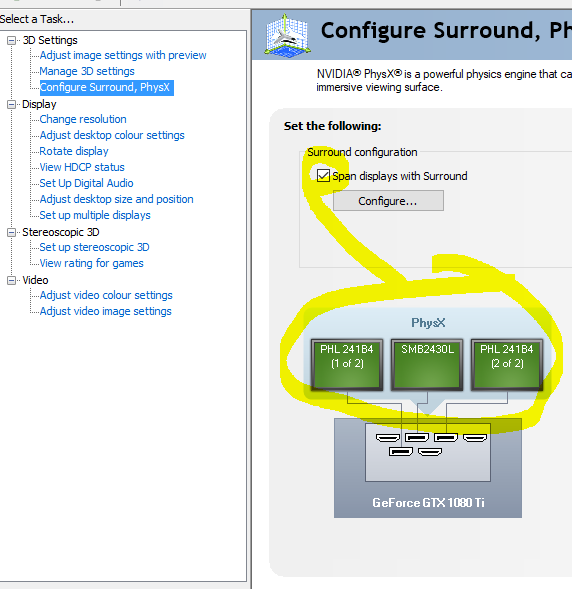

DSR is missing because these 2 machines are my test machines…i have dsr enabled when i have the 3 screens as 3 seperate screens… but when i make them infinity screens the dsr options are removed.
here is the place in the control panel that i add the 3 screens to make 1 infinity screen.
and if i disable the infinity screens the3 dsr options come back as shown here
Eno

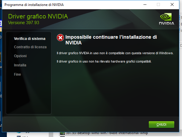

I’ve checked your suggested driver and it isnt for Windows 10 but I can try it as I have some time don’t worry. I’ll try also to reinstall Elite cause looking around web people had low gpu usage too and solved it reinstalling the game. As you can see, is not fast to do all that stuffs.

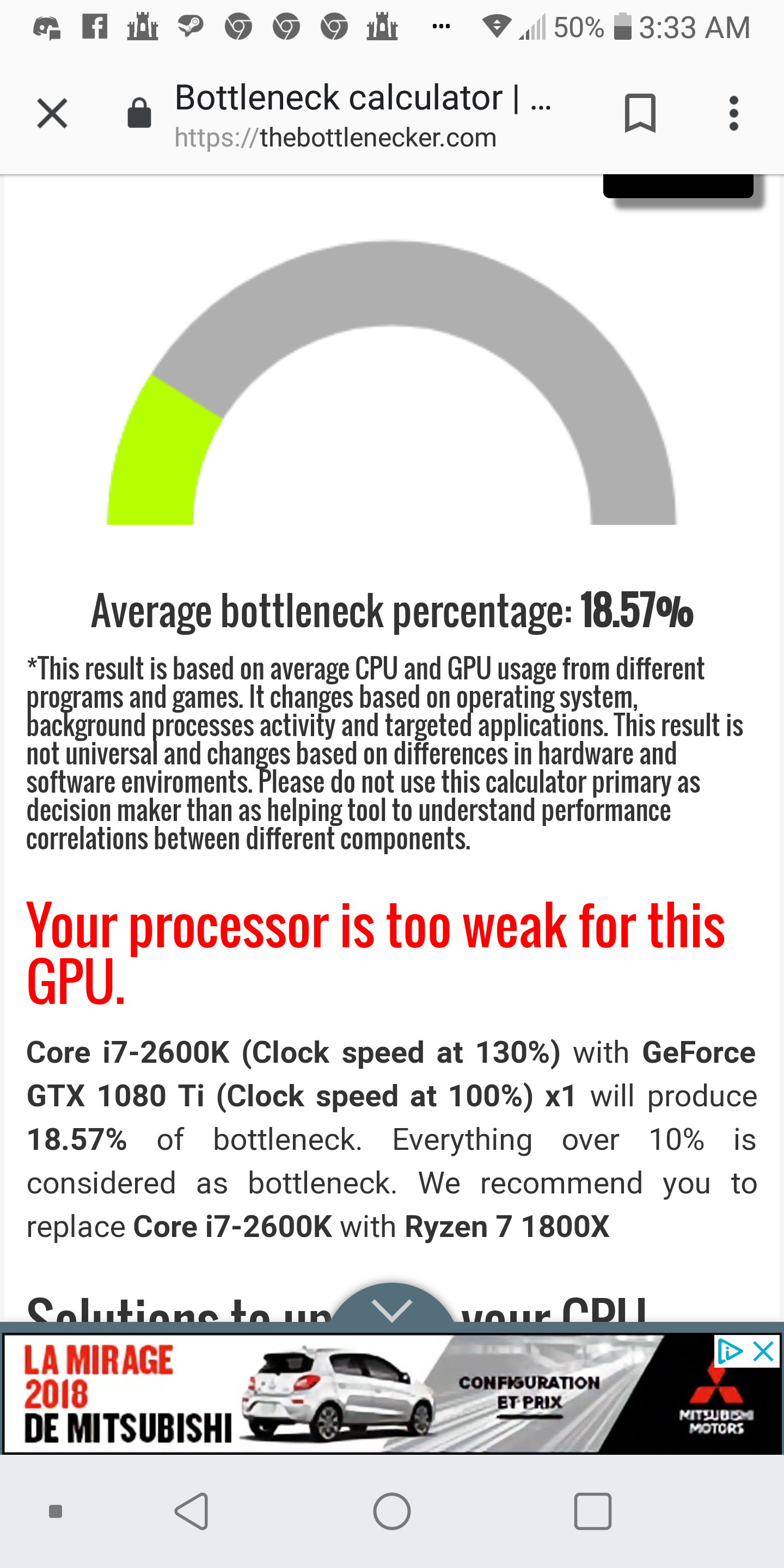

Now I did a check on the bottleneck calculater with 130% cpu & it shows your cpu can bottle neck the 1080ti around 18%
So on it’s side it’s reccommending a processor upgrade as it says any bottleneck above 10% my i5-6500 had a whopping 42% bottleneck. Where my Ryzen 7 2700x is no bother at all. Think was atlround 3%

You should seriously stop using that site to see if Your system is bottle-necked in any way… :slight_smile:
It’s pretty simple, if You GPU doesn’t hit 95+% Your CPU/MEM might be holding it back.
That being said, You might also just be hitting 90 FPS (VR) or Your framerate might be otherwise capped (Vsync/Gsync/FreeSync) if You’re pancake-gaming.
The easiest way of telling if Your CPU is bottlenecking Your GPU would be to use the fpsVR tool (and check during VR gameplay) or run a few benchmarks/games while having an OSD monitor enabled (i.e. “CAM” or the like) during pancake-gaming (without previously mentioned “capping” stuff enabled).
If You’re seeing a low GPU usage and a high CPU usage and You’re not capping the FPS (like mentioned above), Your GPU might be bottlenecked.
I’m using a 1080ti on an old Xeon X5680 overclocked to 4.3GHz, and according to that site, my GPU is bottlenecked 24.5%. Trust me, it’s not… :wink:
The only time that CPU is at work is when it’s benchmarked.
Would I gain something from upgrading to a platform with DDR4 memory? Sure! But not 24.5% in raw FPS… :wink:
As soon as You hit the high resolutions (and by that, lower the amount of FPS) it becomes the GPU that’s the bottleneck unless You have a really, really lousy budget CPU or the game is really CPU heavy.

Hi Eno I couldn’t install this driver nvidia%20not%20comp
