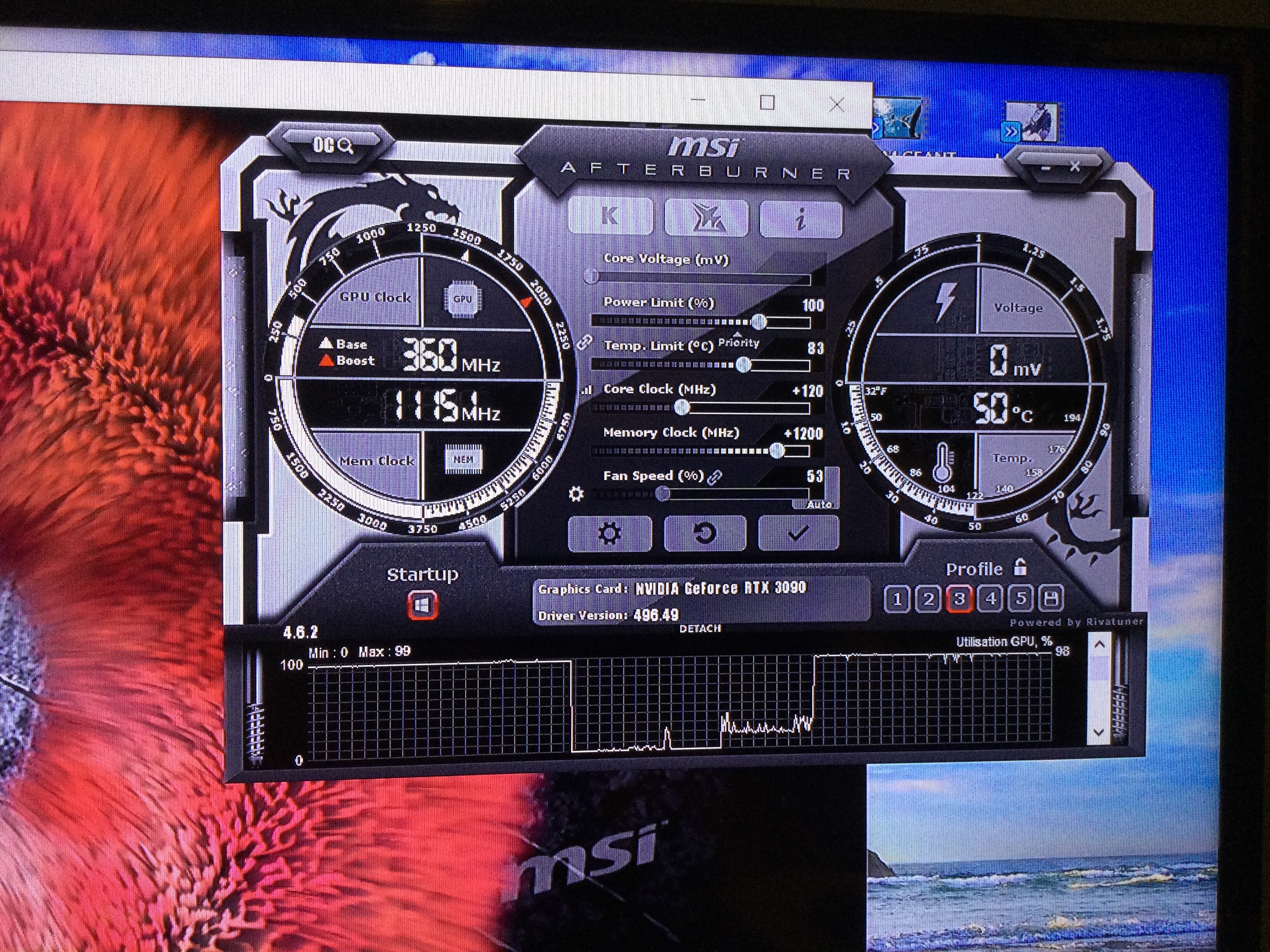

Ha ha, thanks man, didn’t have to go further than step 1, it was my GPU. I did a stress test with Kombustor and for some reason my GPU was stuck at 360Mhz. I changed the different OC on the Afterburner and finally the GPU took off. Now you can see in the pics below how my system works. Thanks again
 ![IMG_0172](https://community.openmr.ai/uploads/default/original/3X/d/1/d1ab9f544ed82cc66bb02a0f5fbb1168b839d24e.jpeg)
 ![IMG_0177](https://community.openmr.ai/uploads/default/original/3X/4/c/4cbf7e14bbe9fc9143b79d223bee4031060a0be3.jpeg)
 ![IMG_0181](https://community.openmr.ai/uploads/default/original/3X/b/2/b2daa01634ec05e6e117b6fa9ed146ca4b08c2da.jpeg)
 ![IMG_0182](https://community.openmr.ai/uploads/default/original/3X/f/5/f54775c2bdde8007821fb293f83bb130270a948b.jpeg)

Thats great to hear, glad we sorted it out so quickly! 🙂
Ive done this a few times as well actually, having several profiles in Afterburner, I forgot to change to my gaming profile, and got panic when framerate was super low because of the clocks not going further than 800Mhz 😛
By the way, nice overclock on the VRAM memory, my 3090 cant handle +1000Mhz it seems.
Ive noticed you dont go over 100% power limit, is there any reason for that? I use to max it out (around 470W at max on the GPU), and it lets me overclock the core a bit more. Not on the memory though.
Actually I don’t have to touch this, it goes up to 127% without asking my permission 😉
