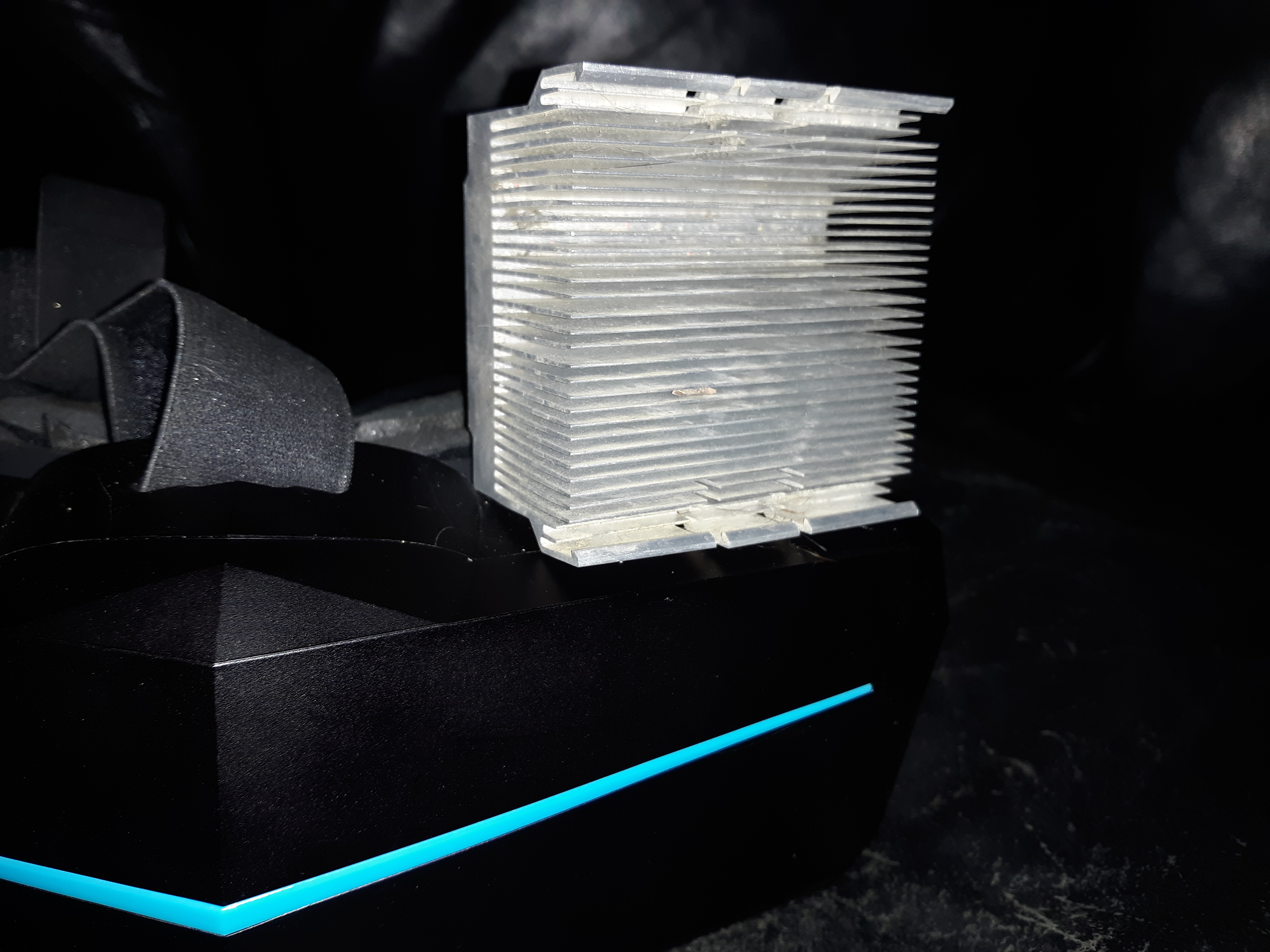

For the cable, a 3D printed part could provide an extremely robust enclosure for a fan. The kind you could step on without injury to human or machine.
New Pimax cable assembly
Not sure I understand what your saying. These self mods on Pimax are getting crazy!:crazy_face::woozy_face::wink:
A fan inside a large ‘bead’ like thing clamped on the cable.
