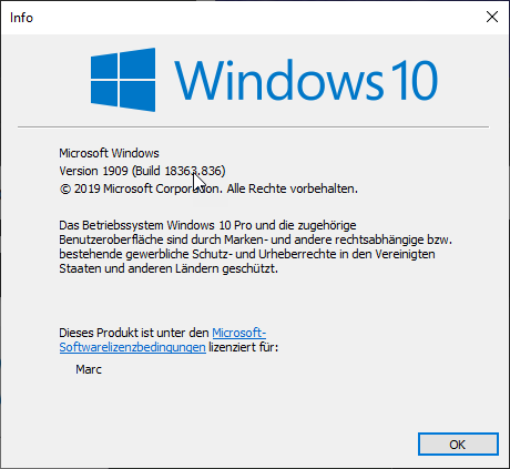

Well… here a short guide:
1.) Get the new Firmware or the one you want, I keep mine in here (just so i know where they are, I made Firmware folder)
C:\Program Files\Pimax\Runtime\dfudriver\Firmware
–> latest pre alpha is something like “P2_RELEASE_M264… .dfu”
–> original is something like “P2_RELEASE_M260… .dfu”
2.) Be sure your drivers are up to date (445.87) and that you have the latest PiTool (V 1.0.1.258 -> post 2020.3.24 stuff) and windows is up to date -> use [windows] and type “winver” to show the version.
REBOOT Clean ! (never hurts)
