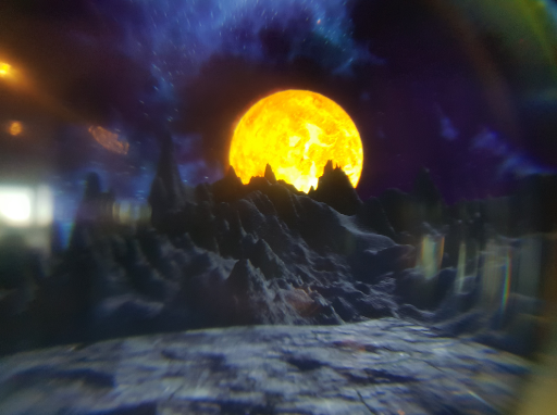

Just to help confirm. I’ve just now completely uninstalled steamvr on my pc, powered off/on and my pimax is ‘still’ tracking fine using LH in the default planet environment.
So either something going on with USB, software/drivers/firmware, the Lighthouses or the HMD sensors. If its not tracking at this part.
